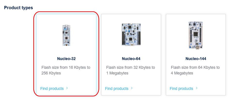

The smallest Nucleo is the Nucleo-32:
https://www.st.com/en/evaluation-tools/stm32-nucleo-boards.html
that looks about the same size as your "pill"?
