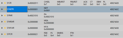

now I will record 32 GPIO's via DMA for the analyse. The DMA itself shall triggered with a timer.
So first I have found different information to solve this. So I have tested some solution, but on the STM32F756 will it not run.
My solution is: GPIOD and GPIOE tranfer with two DMA streams to an public array. After the DMA transmition complete I will start the ISR to switch the buffer.
At the moment, the DMA transfer is not started. The timer runs, but the NTDR register is not changed.
Here my configuration for the DMA and timer:

In F4/F7 there is no connection between DMA1 and GPIO - see the first big picture in the RefMan. Use DMA2.

Instead of the Cube/LL gobbledygook, read out and post the TIM and DMA registers' content (and you are better off writing that, too).
> memory to memory
No. Read DMA chapter, what "memory to memory" means.
> using of DMA2 instead of DMA1
Yes.

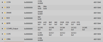

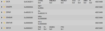

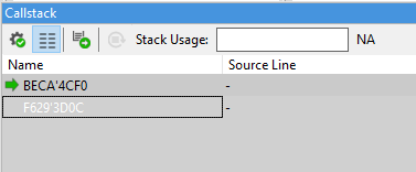

After the crash the following DMA and timer configuration are shown:
DMA2:
TIM1
TIM8
Whre come this crash? If it a problem with the timing otself? Booth timer have the same timing.

Registers look OK.
The crash is outside of what you've shown us.
TIM1 just rolled over (or under - choosing downcounter is weird, and also are you sure you want to set up TRGO/TRGO2? they are harmeless now but not needed for this exercise either) as witnessed by it CNT, and DMA2Stream just triggered a Transfer Complete as witnessed by NDTR and the flags in HISR.  As the flags (namely TC) is not cleared and you have interrupt on TC enabled, the crash is most probably consequence of the interrupt, most probably incorrectly handled.
Check - best in mixed C/disasm view - that the proper vector to the ISR is inserted to proper position inside the interrupt vector table. If not, check if the ISR name matches exactly (noting that C is case sensitive) that in the vector table (usually in the startup code; the interrupt chapter in RM contains the reference list of interrupt vectors). If you use C++, mind name mangling.

Thanks all, now I found the last problem. It was the debugger. I user the winIDEA from iSystem with iC5700. And here I must configured a reset after download a new firmware. And I've forgot this. So is artifacts inside of the registers in the MCU, which can result in ...
So, I hope that was all problems. Now I start my tests of the signal analysis.
