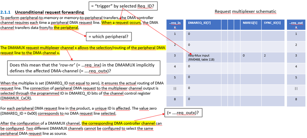

I have tried to make a sketch to explain what is unclear to me. Maybe I am a bad example of a newbe who tries to use the DMAMUX, in that case I'm sorry for bothering you. Here is my sketch:
 I assume my questions are clear

Say, I want to have a DMA action on SPI3-Tx executed, every time an compare event happens on TIM3-CH1:
a) First I define the DMA-action for SPI3-Tx and see it is <DMA1 – Stream0>.
b) In case of a MCU without DMAMUX, I can find a table that shows me the Channel-nr for that DMA-action, with MUX there is no such table.
c) Suppose, I need to choose the channel-nr as x to specify "…req_inx", how do I determine the value ‘x’?
d) Subsequently, how do I specify that ‘channel-nr’ when I want to configure a DMAMUX-request?
e) In the listing of registers in RM0468 I see DMAMUX1_CxCR, where the x stands for that ‘channel-nr’ (if I understand this correctly). BUT: as in the debugger a register 'DMAMUX1_C2CR' appears to be incorrect in the column 'Live Expressions', this syntax is invalid. What name should I use when I want to code a DMAMUX_Request by setting the bits in the register?
Although your answers have not yet resulted in a full understanding, I want to express my gratitude for the efforts you put in this case. Thank you for that,
"Action" (i.e. transfers) are determined only by the addresses in the given DMA Stream's (BDMA's Channel's - again ST"s inconsistent nomenclature) registers. They are entirely independent on the request (trigger) source and routing.
So, in above case
- set up timer, whatever it takes, to generate capture or compare events on TIM3_CH1
- enable DMA request to be output from the timer, by setting TIM3_DIER.CC1DE
- in STM32 without DMAMUX, you'd look at the description of DMA Streams (in dual-port DMA) or Channels (in single-port DMA), to find the particular Stream/Channel into which TIM3_CH1 request is fed (either through an OR, or through a multiplexer - details differ per STM32 family)
- in STM32 with DMAMUX, find the number corresponding to TIM3_CH1 in the DMAMUX1: assignment of multiplexer inputs to resources table, as we discussed above. You can choose any DMA Stream/Channel you want, and in the corresponding DMAMUX Channel's Control register, set this number to the DMAREQ_ID field
- in chosen DMA Stream/Channel, set the Peripheral address register (DMA_SxPAR/BDMA_CPARx) to SPI3 data register's address, and then set up the memory register, number-of-transfer register, the fields of control register including enable. This assuming, SPI3 has been set up properly for transmission previously (i.e. that if you'd write to that SPI3 data register from processor, SPI3 would transmit a frame).
Optionally then you want to enable and handle interrupts from DMA etc.
