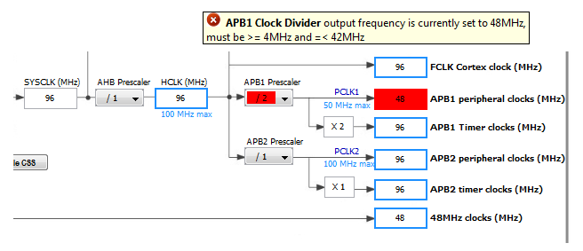

There appears to be conflicting information in the maximum APB1/APB2 speed on the STM32F411 chip, in both the data sheet and the STM32CUBEMX software.  I was hoping someone here may know more about why this is.

I wouldn't have even noticed it except that in the STM32CUBEMX software, it gives an error if I try to set the APB1 clock above 42 MHz. Interestingly, no such error is given if I set APB2 above 84 MHz.
I've used the 100/50 setting for APB2/APB1, and honestly don't think the 50/25 setting would make any sense. That it says 84/42 in the manual is just lack of editing for the F411 context.

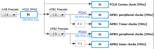

Maximum APB1 and APB2 frequencies are the ones specified in the datasheet (documentation remains the first reference):
However, we still have the error reported in OP in the reference manual. This will be taken into consideration to be fixed in coming version of RM0383. For sure we should have all our resources aligned to avoid any confusion. Thanks for your help to achieve this.
Please note that there is no more problem with CubeMX to set a frequency > 42 MHz for APB1 (I am using the last version 4.20.1):
-Amel
