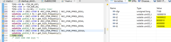

The timer tick frequency is working as intended here, with your code. You are probably misinterpreting something.
> My timer interrupt is twice as fast compared to a APB1 divisor of 1 or 2:
How are you determining this?
mfe
the tick frequency is fine, i use the same values as yours. However, the timer interrupt is called twice when using divisor > 1. For example, when using a divisor of 4 (_DIV4), i setup the timer TIM2 as follow:
TIM2->PSC = 8 - 1; // 4 MHz (APB1 clock) x 2 = 8 MHz
TIM2->ARR = 100 - 1; // Timer should be called each 0.1 ms
Timer interrupt handler:
void TIM2_IRQHandler(void) {
  cnt++;
  cnt_us += 100;
  TIM2->SR &= ~(1<<0); // Clear UIF update interrupt flag
cnt is the number of 0.1 ms, e.g. cnt = 10 -> 1 ms, cnt = 10000 -> 1s.
cnt_us are the number of microseconds counted so far. Both variables are volatile declared to prevent compiler caching.
A simple wait function for testing:
void delay_ms(volatile uint32_t ms) {
  unsigned int old = cnt;
  while (old + (ms * 10) > cnt) {
    __WFI();
int main() {
  // ... setup timer here ...
  while(1) {
    delay_ms(1000);
    printf("%i\n", cnt); // outputs to USART2 for debugging
Output when using a divisor > 2 is twice as fast as using a divisor < 2.
