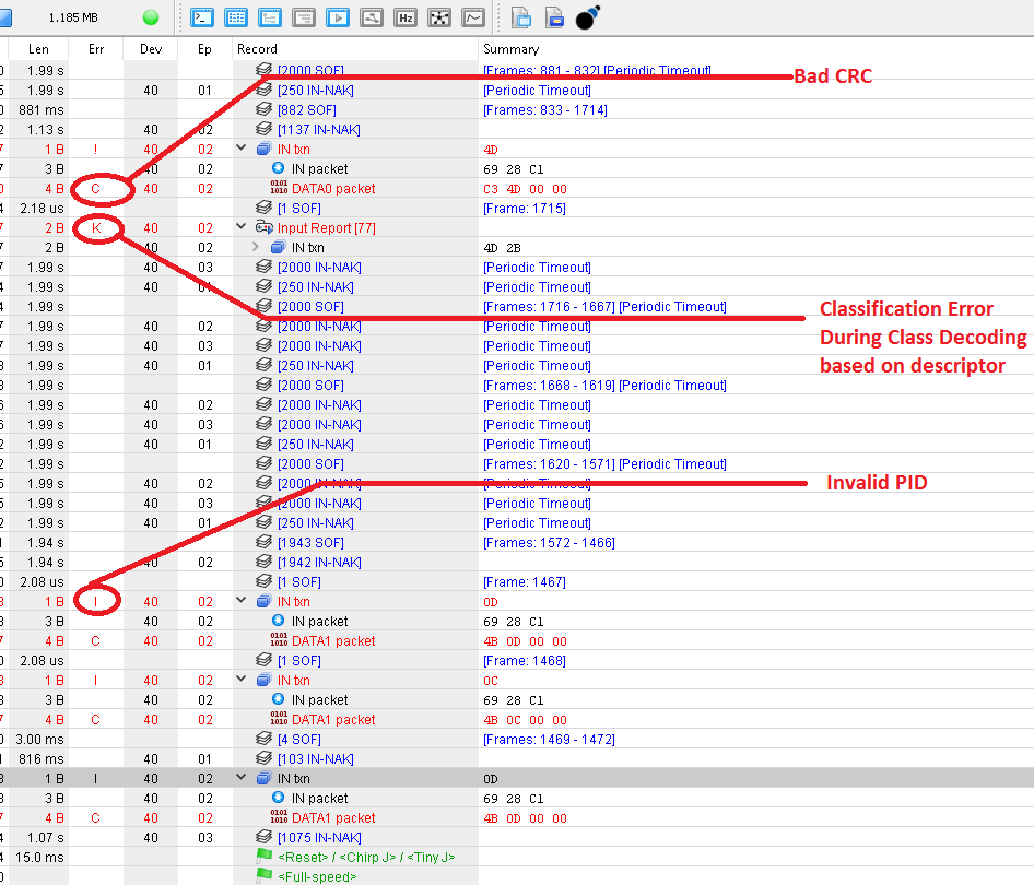

I think I found a bug in the STM32F4 USB controller which is not addressed correctly by the cube library v1.13 and which is not documentend as well. I'm developing on the STM32F437IIH and I use the USB OTG_FS. The problem occurrs only with at least 2 USB endpoints. Endpoint 1 (IN and OUT used) and endpoint 2 (only IN used) are used in bulk mode. The problem occurrs if I'm writing on Endpoint 2 in the funtion HAL_PCD_IRQHandler ->PCD_WriteEmptyTxFifo ->USB_WritePacket from a low priority interrupt. The important routine here is:
for
(i = 0U; i < count32b; i++, src += 4U)
USBx_DFIFO(ch_ep_num) = *((__packed uint32_t *)src);
If during writing to this data fifo a second higher priority interrupt is interrupting this routine and a register access is happening in the higher priority interrupt (i.e. inUSB_EPStartXfer to start writing on USB EP 1) then the state machine for the EP2 gets confused and this leads to the transmission of the so far written USB data in the fifo and a CRC error. After 3 erroneous transmissions the controller stops transmitting data on the USB for this endpoint. Because there is an array to distinguish between different endoints I would expect that I can access the data fifo for different endpoints independently. But this doesn't seem to work. This routine would cause such a behaviour during an interrupt.

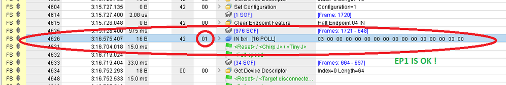

I have the same issue it seems, It is very serious. Debugged this for quite a while until i found this post here.
I amalso getting bad transfers on EP2 (and possibly any of the higher EP1 above 1) and have it traced down to exactly this function to be called with the correct data being supplied. 16 Byte Buffer is defined but only 2 reach the PC and it is totally wrong data. Sometimes the Beagle 5000 reports bad CRC as well. EP1 is all ok.
Here is what I see in the USB Analyzer:
This is what is called:

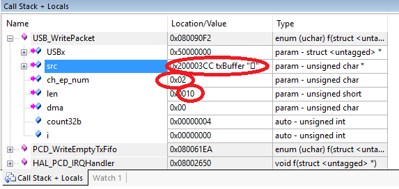

USBx_DFIFO(ch_ep_num) = *((__packed uint32_t *)src);�?
And here is the Route Call Stack just before the sent:

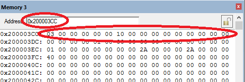

And Finally here is the Buffer to Send:

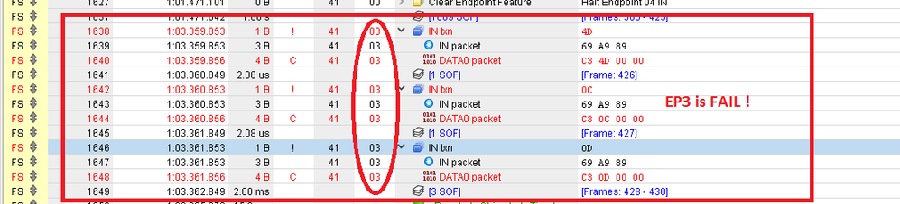

If I try the same thing via EP3 it also fails:
