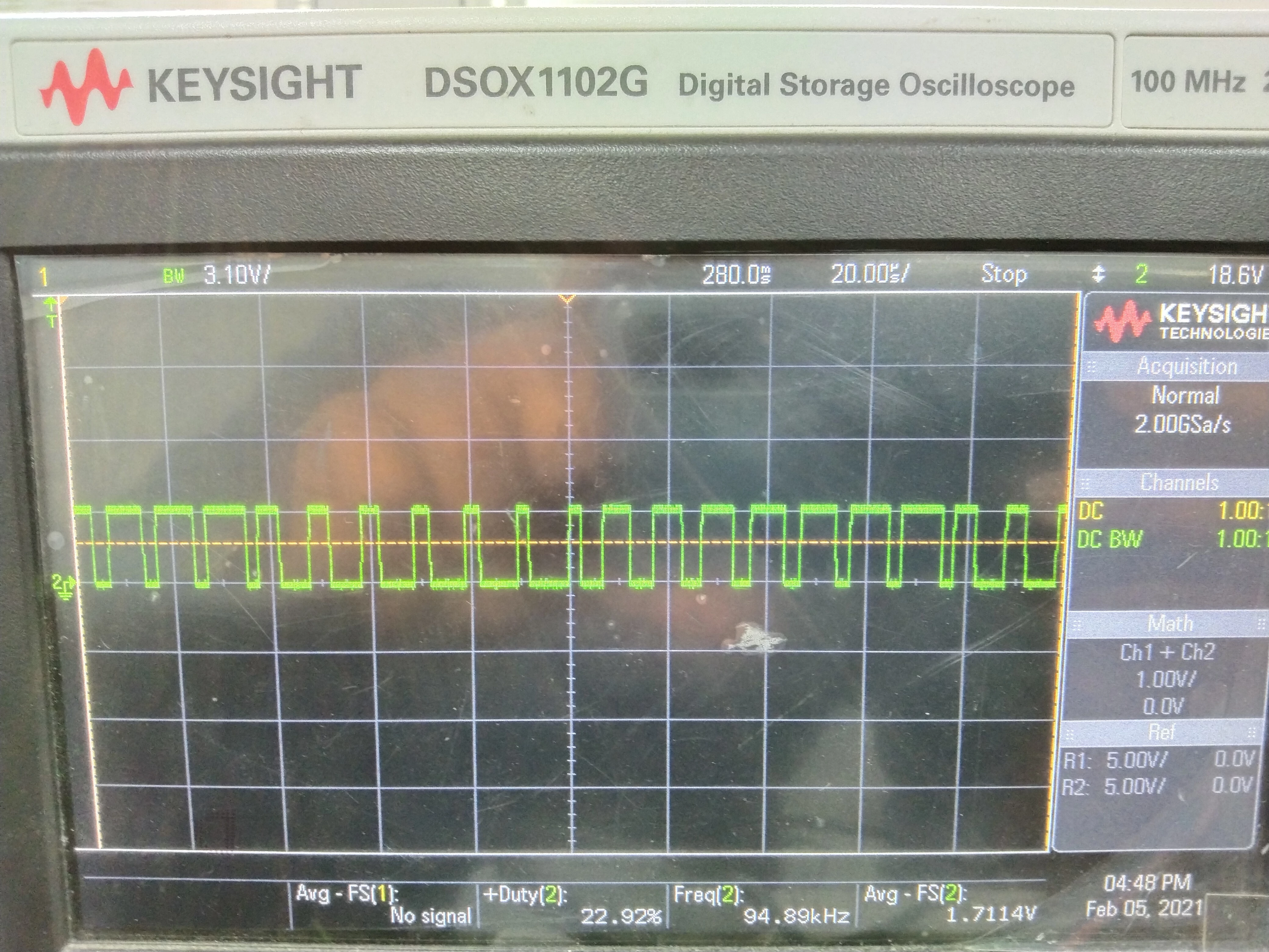

0693W000007E6cvQAC.jpg0693W000007E6cMQAS.jpg0693W000007E6biQAC.jpgHello everyone,
I use a STM32F407VET6 MCU board and I'm trying to implement a Timer 8 Interrupt, every 5u sec. In my code, I also use an ADC interrupt, for ADC conversion purposes. I thought that these 2 interrupts are independent. I observed that when I have both interrupts enabled , Timer misses out and no update interrupt is serviced. I even tried involving DMA but didn't yield appropriate result.

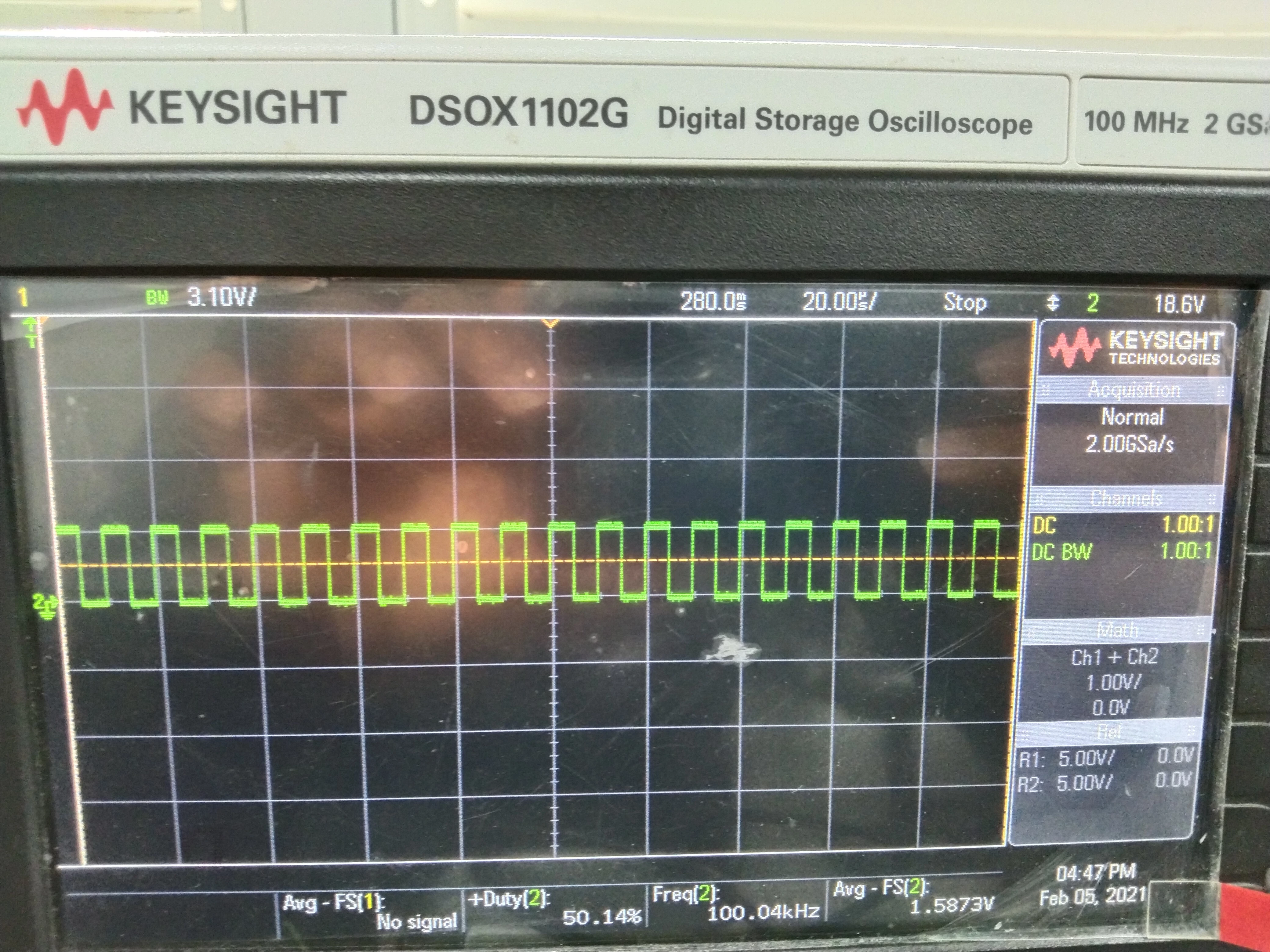

I came to the conclusion that " there's a conflict between the ADC interrupts and the timer interrupt when i commented the software command of ADC and toggled the PD11 pin in the callback function. I attached the code , clock config and the waveforms.
Please provide some help!

Only one interrupt handler can run at a time. Higher level interrupts interrupt lower level ones and all interrupt the code in the while loop.
If your goal is doing ADC conversion at a fixed sample rate, you could use a timer trigger event which will trigger ADC in hardware only, without the need of an interrupt handler. This is done by selecting e.g. Timer 8 Trigger Out event as External Trigger Conversion Source in ADC1. In TIM8 you set Trigger Event Selection to Update Event.
When ADC is done, you get the ADC interrupt. This could also be changed to cyclic DMA, i.e. a series of ADC results is automatically transferred to a ring buffer and you have to implement HalfFull and Full handlers for further processing the data in larger chunks.

Hi! thanks for the response and sorry for the indentation. My main goal is , at every start of the 5 us the ADC has to be sampled and it will be computed with some variables only once in the cycle. Let me explain further, I am using Timer8 for generating a sawtooth wave for reference, the period of the sawtooth wave is 5us(200Khz). IN each cycle The ADC has to be sampled and the computation has to be taken place only once and it waits until the next rollover happens and this process continues.
Yes I can use TIM8 Trigger output to trigger the ADC, but keeping in mind that I will be using ADC in Dual regular simultaneous mode (4in ADC1 and 4 inADC2 in scan mode with software trigger with help of DMA) for which i need to have an interrupt. How can I run two interrupts in my program without conflict.
Can I run timer interrupt in blocking mode or nesting of interrupts that can be done. If nesting of interrupts can be done then can someone share that how can that be done in STM32 MCUs.

Interrupt nesting happens automatically if you choose different priorities (preemption levels). Smaller number --> higher prio. Can configure that in STMCubeIDE or use a CMSIS function https://community.arm.com/developer/ip-products/system/b/embedded-blog/posts/cutting-through-the-confusion-with-arm-cortex-m-interrupt-priorities
