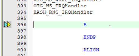

the program gets stuck here
‎2021-09-26 8:43 PM
Did you create the exti interrupt handler function? If this looks difficult to you, get a files compare text viewer, generate a simple concisr project for spi and exti, look at both anf try to merge. Exti and spi are decorrelated function. You decide when each one has to be enabled
