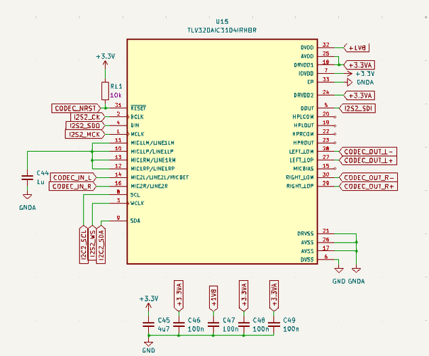

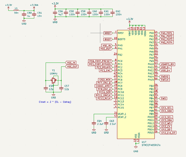

Hi guys, i have a difficult task of communicating the stm32405RGT with a TLV320AIC3104IRHBR, I need to do a simple buffer and pass the guitar signal, process it without any changes and send it to the output again.
I'm actually trying to replicate what "Phil's Lab" did in this series on his YouTube channel: https://www.youtube.com/watch?v=zlGSxZGwj-E
In principle, my hardware is checked and correct, I don't have any problems with my board, but I don't get any signal on the i2s2_sd and i2s2_ext_sd, only on the pins i2s2_ck (1.56MHZ square wave), i2s2_ms (48.8Khz square wave), i2s2_mck ( 12.5Mhz sine wave), these pins are receiving the necessary signals, but nothing happens to the data pins, and I have already made sure that the audio signal has reached the codec correctly.
i2s configurator:
static void MX_I2S2_Init(void)
 hi2s2.Instance = SPI2;
 hi2s2.Init.Mode = I2S_MODE_MASTER_TX;
 hi2s2.Init.Standard = I2S_STANDARD_PHILIPS;
 hi2s2.Init.DataFormat = I2S_DATAFORMAT_16B;
 hi2s2.Init.MCLKOutput = I2S_MCLKOUTPUT_ENABLE;
 hi2s2.Init.AudioFreq = I2S_AUDIOFREQ_48K;
 hi2s2.Init.CPOL = I2S_CPOL_LOW;
 hi2s2.Init.ClockSource = I2S_CLOCK_PLL;
 hi2s2.Init.FullDuplexMode = I2S_FULLDUPLEXMODE_ENABLE;
if (HAL_I2S_Init(&hi2s2) != HAL_OK)
 Error_Handler();
i2c configurator:
static void MX_I2C2_Init(void)
  hi2c2.Instance = I2C2;
  hi2c2.Init.ClockSpeed = 100000;
  hi2c2.Init.DutyCycle = I2C_DUTYCYCLE_2;
  hi2c2.Init.OwnAddress1 = 0;
  hi2c2.Init.AddressingMode = I2C_ADDRESSINGMODE_7BIT;
  hi2c2.Init.DualAddressMode = I2C_DUALADDRESS_DISABLE;
  hi2c2.Init.OwnAddress2 = 0;
  hi2c2.Init.GeneralCallMode = I2C_GENERALCALL_DISABLE;
  hi2c2.Init.NoStretchMode = I2C_NOSTRETCH_DISABLE;
  if (HAL_I2C_Init(&hi2c2) != HAL_OK)
    Error_Handler();
initialize chip:
  GDSP_Codec codec;
  GDSP_Codec_Init(&codec, &hi2c2, CODEC_NRST_GPIO_Port, CODEC_NRST_Pin);
  HAL_Delay(60);
  HAL_StatusTypeDef status = HAL_I2SEx_TransmitReceive_DMA(&hi2s2, (uint16_t *) dacData, (uint16_t *) adcData, BUFFER_SIZE);
**HAL function return is ok.

Schematic stm:
Schematic codec:
The i2c pins are in pullup and the other i2s pins are floating (default configuration), but I put the date pins in pullup and they still didn't work. Furthermore, I believe that all the commands when initializing the chipset are correct, as they were taken from the video in question.
Anyway, any brilliant minds out there to help me?
