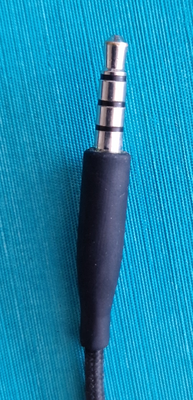

So I'll try if it works. Thank you. I use this headphone jack for samsung (I'm not sure is the CTIA type) for recording :

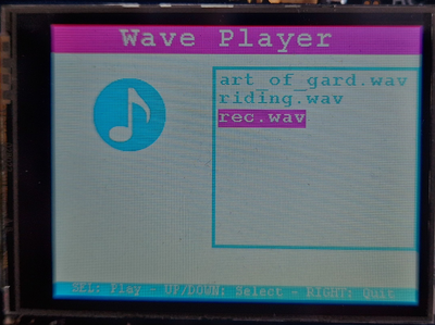

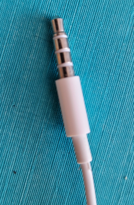

I can hear the examples on the evaluation board (art of gard.wave and riding.wave). But when I select rec.wave to listen to what I recorded and I hear nothing. In the evaluation board, a white earphone is provided in the kit, do you know if it is compatible with the card for recording ?
‎2023-09-01 3:58 AM
After trying with the headphones provided in the kit, it does not work either.
I don't know if I need to put a jumper somewhere on the board for this to work ?
‎2023-09-01 7:00 PM
The later one, white headphone, should be the CTIA type headphone with microphone - as I remember, white join between points is CTIA type headphone.
I suppose the white headphone provided in the kit should support the board demonstration. You may plug it to your mobile phone to check if it can record voice.

‎2023-09-02 2:45 AM
in case you don't have phone to verify the earphone, you may check earphone signal with oscilloscope when plugging headphone to the audio jack of board.
Did you verify the jumper setting?
@note Jumpers setup on MB1372_L552ZEQ-C02: JP1 : OPENED / JP4 : 1-2 (LEFT) / JP5 : 1-2 (LEFT) / JP6 : CLOSED JP7 : 1-2 (RIGHT) / JP8 : 1-2 (LEFT) / JP9 : 1-2 (DOWN) / JP10 : CLOSED JP11 : 1-2 (LEFT) / JP12 : 1-2 POT / JP13 : 2-3 OPAMP / JP14 : OPENED JP15 : 1-2 (VDD) / JP16 : 5V-STLK / JP17 : 1-2 (RIGHT) / JP18 : OPENED JP19 : OPENED / JP20 : OPENED / JP21 : OPENED / JP22 : OPENED JP23 : OPENED / CN12 : OPENED / CN23 : OPENED

The earphone is ok and, really and I think there is no problem with headphones + microphone.

@jiangfan wrote:as not clear if microphone of headphone OK or not.
Now I'm sure that both microphone of headphone (white and black) work, I recorded sound (microphone of headphone) with his headphones via VLC+Laptop and it works. So how does the demo program work ? It's not necessary to connect a 1kHz or 2 kHz sine to the microphone, it's not very clean DIY.
