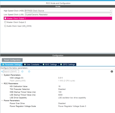

Parameter settings for RCC:

For Nucleo boards, the MCO from the debugger is used as the clock source for main MCu. Try to configure the MCu for an internal oscillator or place a crystal and auxiliary capacitors to the MCu and select the External Crystal as the clock source. The problem can also be a slow start of the clock and then the program jumps into some error routine, that also needs to be treated.
