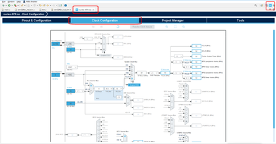

Also look at the graphical representation in the STM32CubeIDE Device Configuration Tool - it shows you all the clock sources, routing, etc.
This is a different chip, but shows the idea:
Chaitanya96
Hello @Andrew Neil,
I have been currently working with HAL and since in L452RE clock configuration, both APB1 and APB2 both have same maximum clocks similar to the example you stated, it created the confusion. But after referring reference manual my doubt was cleared for this particular controller. Thanks
