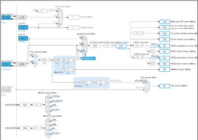

The Clicker2 features a 25 Mhz Oscillator that I am certain is for the HSE and also features a 32.768 KHz oscillator that I am certain was meant for the LSE. Leaving all the specs as factory as possible (using the the internal oscillators) in CubeIDE I can get code to work as expected. However, I would like to set the MCU at 168 Mhz (not sure that makes any difference yet).
As an expeirment, I used the 168 Mhz settings in the native MikroElectronica IDEs (which seems to set HSI instead of HSE) and it all works. But they do a really good jobs of abstraction and therefore I can not ascertain how they set it all up.
Here's my attempted settings in the CubeIDE:
I2C2: I2C (Facilitates the MikroBus 2 position)
I2C3: I2C (Facilitates the MikroBus 1 position) (Conflicts with RCC MCO1 on PA8 when enabled)
RCC HSE: Crystal/Ceramic Resonator
RCC LSE: Crystal/Ceramic Resonator
RCC MCO1: Checked
RCC MCO2: Checked
No matter what I do, I am missing something and I can't get it to run on 168 MHz as it does in the native MikroElectronica IDEs. I have tried bypassing HSE, Using HSI instead at /16 all to no avail. Would anyone be willing to guide me to a solution?

how you test the core speed ? what its doing with your clocktree in pic , should run 168M ?

Ok, but the led is not blinking in PE12 with 168MHz ? and lower freq -> led blinks ?
Can you share also your ioc file ?

Hello
Try to comment out MX_SDIO_SD_Init(); or remove it from CubeMx. Does it affect to your problem ? It seem to end up to error handler if SD card not present.
Br J.T
