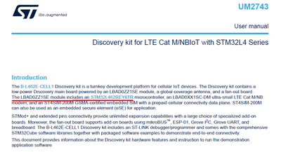

Hello @SSWM and welcome to the community,
You need to download these tools:
STM32CubeMx tool from here.
STM32CubeIDE toolchain from here.
You need to refer to the user manual of the board: UM2743
According to this documentation, the board is based on STM32L462REY6TR microcontroller:

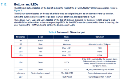

Now we need to know which LED resources are available on the board. Again, the same user manual provides it in the table 4 as well as their GPIOs connections:
These information are sufficient to start to blink LED(s).
Not obvious to tell you step by step how to do as it will be an article but I've created a project for you with which LD1, LD2 and LD3 are toggling.
If that answers your question please accept it as solution.
Thank you.
