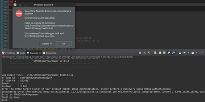

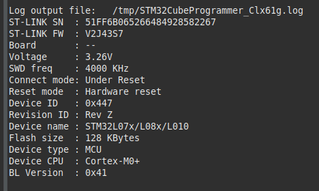

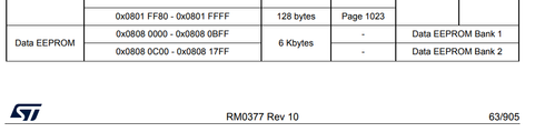

I'm using the internal EEPROM bank 0 for the STM32L073 chip located at 0x08080000 (as per the user manual).
After writing my data (less than 1K; and bank 0 has 3K capacity) and trying to enter into debug mode, system refuses to do so:
(BTW: such log file isn't created: tmp/STM...log)

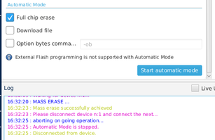

In order to bring the chip back from this brick mode I need to apply a mass erase operation using the STM32CubeProgrammer:
And then I can enter into the debug mode again:
