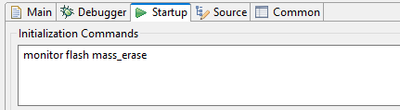

Just to unblock the situation: if you add mass erase command before to upload the application:
add: monitor flash mass_erase command as startup command.
Go to the startup tab in the debug configuration and add "monitor flash mass_erase" as an Initialization command like the following:
Does at least workaround the issue?
