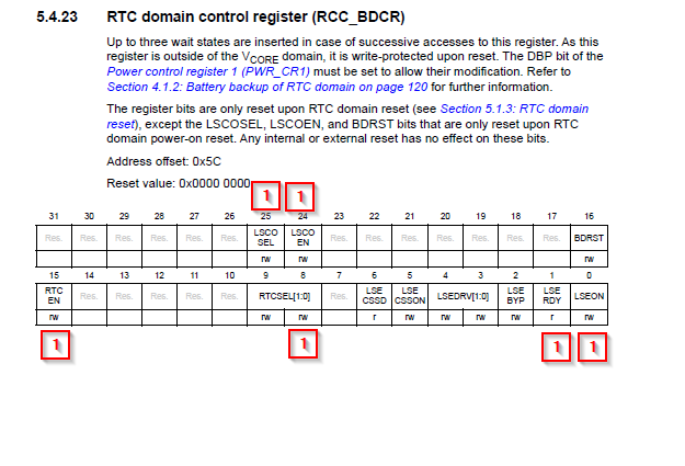

luuuuuuu1
The RCC_BDCR register is configured as follows:
waclawek.jan
you do need to enable the RTC APB clock (in RCC_APBENR1).
luuuuuuu1
RCC_APBENR1 |= RCC_APBENR1_PWREN_MASK + RCC_APBENR1_RTCAPBEN;
Oh god.. I've used the bit position instead of the mask.
Thanks so much!
RCC_APBENR1 |= RCC_APBENR1_RTCAPBEN_MASK;
