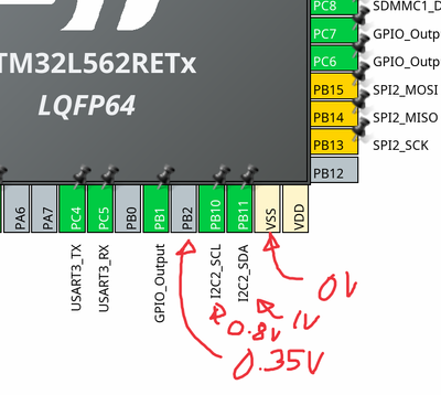

Hello - I recently took a working design and upgraded from the STM32L4 to the STM32L5. I'm having a major issue getting the i2c bus to work properly.
  • I have SCL (PB11) and SDA (PB10) configured.
  • I have pull-up resistors (4.7 kohm) on each of SDA/SCL. I've confirmed that it is 3.3V on the outside of thoes resistors.
  • I've configured this in STM32CubeMX to be I2C2 (I've attached the .ioc file)
  • I'm almost certain the clock configuration is correct (attached the .ioc file)
  • When I disconnect the STM32L5, each bus properly pulls up to 3.3V.
  • However, when connected to the STM32L5, it immediately pulls SDA to 1.0V and SCL to 0.8V despite it being 3.3V on the other side of my pull-up resistors.
  • I've tried everything I can think of in firmware (stm32duino and STM Cube IDE) to fix this, but there isn't a single thing that works.
  • Trustzone is disabled (see option bytes below)
Here is the design, I've highlighted PB10 and PB11. Not visible in this is the 4.7 kOhm pull up resistors, but you'll have to trust me, they are there (just in a different part of the design)
Here's a picture of the board with the pull-up resistors visible:
And here's my pin configuration for PB10/11
I've also attached a copy of a simple Cube IDE program you can compile and run which performs an i2c scan. However, the scan files because both SDA/SCL remain at 0.8V and 1.0V the whole time and are never allowed to pull high. These numbers don't even make sense - why 0.8V and 1.0V?!

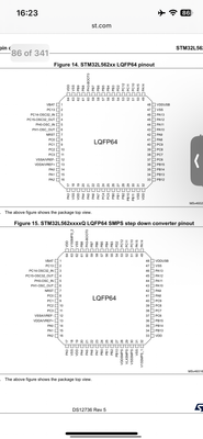

Best answer by TDK
> STM32L562RET6
Close! Actually it’s STM32L562RET6Q. you can see the marking in your photo.
Sounds like you have an SMPS chip. Should be a Q at the end of the part number. These pads are not PB10/PB11 but rather SMPS pads.

> STM32L562RET6
thayden
thaydenAuthor
July 7, 2025
OMG my PCBA put on the wrong chip 🤦 You are 100% correct. Thank you so much.
