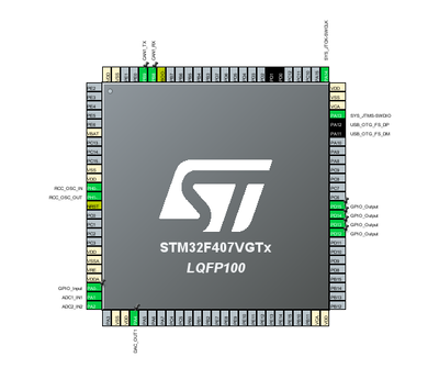

Hello everyone,
I’m currently experiencing difficulties with setting up CAN communication on my STM32F4 microcontroller. Despite having configured the CAN interface and connecting it to a CAN transceiver, I observe no activity on my designated can_tx and can_rx pins. I have a second node connected for communication testing.

2025-05-18 10:45 PM
Hello mƎALLEm,
Thank you for your time. I am working in a lab and have access to another node which is conformingly working.
Regarding point 2: The RS pin is connected to ground, which should be correct.
Regarding point 3: The schematic has already been debugged and confirmed to work properly.
However, I am facing an issue where the board is not sending signals through the RX and TX pins. So my problem should be a software issue.
2025-05-18 11:01 PM
Thank you for the information.
These examples would be very helpful for me, but I'm unsure where to find or download them.
> It seems this are only CAN_2 and PB12 / PB13 are available, the other pins are connected to onboard peripheral.
Im not quite sure what you are trying to tell me.
I could move my CAN1_TX and CAN1_RX pins to the pins colored black.
Thanks
2025-05-19 12:49 AM
Check the schematics of the F4 discovery.
Plus, there is a table in the user manual (of the F4 Disco), which explicitly lists GPIO pin usage and assignments.
If a GPIO pin is already connected to another peripheral, this will definitely interfere with your project - unless you modify the hardware. From the CAN Tx/Rx pins, only PB12 and PB13 are marked as "Free IO".
2025-05-19 1:45 AM
