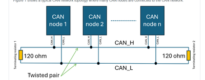

Please to share the schematics of the CAN part + a sketch of the CAN bus, otherwise I cannot help you efficiently. Words cannot tell everything.
That's an example of a sketch:

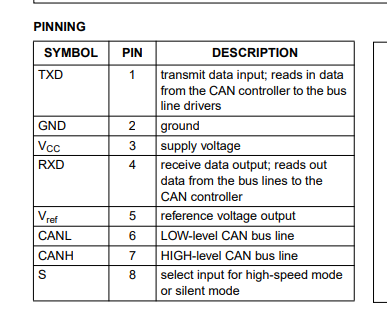

What about the Power supply of the CAN transceiver? how did you power supply it? It's a 5V transceiver and not a 3.3V one!
What about S pin voltage level of the transceiver?
The default mode is at high speed but I need a confirmation that S is not pulled up to VDD in your hardware (transceiver in a silent mode: you are not able to transmit). Please measure it with a multimeter or an oscilloscope.
That's why I asked also for the schematics!
It's a 5V transceiver  and S pin connected to GND. but still i cant see CAN Frames on Bus MAster.
