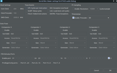

Whats not obvious to me: you write SWV trace , but want only debug messages, so you should set it:
nothing than the port "0" enabled:

The STM32H563RIT freeze during GPDMA1 initialization while SWV tracing is active points to a conflict between the DMA setup and the debug peripheral's state. Since the code runs fine otherwise, the issue is likely SWV bus interference or a timing conflict during the GPDMA clock or register writes. The best solution is to limit SWV to only Port 0 for debug prints to reduce data load, or use breakpoints to pinpoint the exact line of failure.

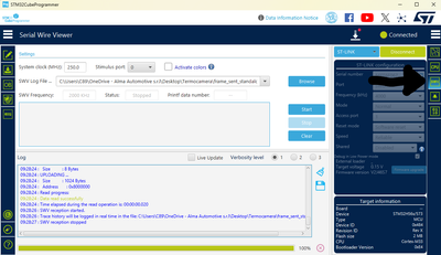

I'll try to explain the problem I'm having again because I think there's a misunderstanding.
I just want to print some debugging information. To do so, I enabled everything in the debug configuration as your picture shows, and it works fine in debug mode.
It also works when I try to run the code in standalone mode, while when I press the start button in the SWV interface it doesn't work.
For testing, I always use the STM32CubeProgrammer to get a log containing the same information I printed in debug mode. To do this, I connect the nReset, SWO, and SWLK pins to the stlink and launch the code using the start button in the STM32CubeProgrammer's SWV interface, as shown in the figure.
I usually get the same output as in debug mode, but not in this case. To understand why I added a printf before and after each init, I noticed that it stops printing after DMA initialization. That's why I assumed the code stopped there.
