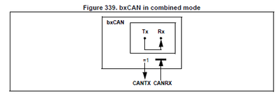

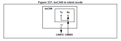

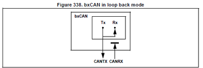

I want to implement CAN Communication in Loopback mode in which I have added Can interrupt mode . In Tx interrupt it will sent data after every 1000 m/s and data increment . In Rx interrupt it will read the sent data. I compiled the code and it will show me the value in live registers.  But I am not able to see that in logic analyzer. Suggest me some ideas to help me out.
mƎALLEm
What config you have enabled?
This one:
or this one:
Or this one?
You need to select the second one and configure the correct GPIO pin.
And don't forget to enable the pull-up for Rx pin.
Otherwise you need to share your project for an efficient help.
