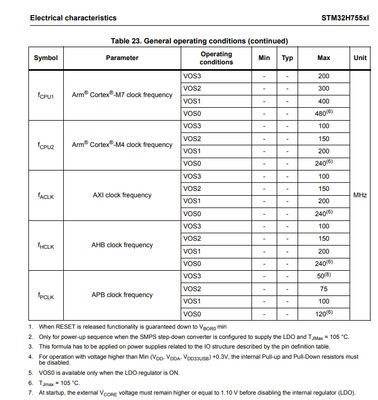

‎2024-10-21 12:25 PM
Dear @kps98 ,
May be you can check the setting of the VOS - Voltage scaling if set as in datasheet and also let us know the Increase/decrease of the Power Consumption from previous to new setting. what was the previous clock ?
If not set correctly the overconsumption can make a non stabilization of the internal Vcore and so loading the flash settings will be corrupt.
Hope it helps
STOne-32.
‎2024-10-21 12:49 PM
There's the potential you've damaged or broken it, or the cables.
If you mess up the LDO/SMPS or VOS settings you can brick the parts.
One recovery method that works in specific cases is to strap BOOT0 HIGH, and cycle power completely several times, until you can connect with the devices and remove your broken code via erasure.
A reset is not sufficient, you must remove power from the board, and any leakage sources.

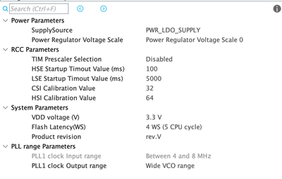

‎2024-10-27 7:50 PM - edited ‎2024-10-27 7:53 PM
I was using 64MHz or something in the beginning as i was not able to increase clock speed without changing Voltage scaling and supply setting. So i didn't do it. But later i read some of the posts in this forum and found that Voltage scaling should be set to scale 0 and supply source should be LDO for it work. That's how i configured it to 480MHz. I also tested the same code i uploaded in two different boards and they work. What concerns me right now is will this happen again or not.
This is my current setting
Thanks
