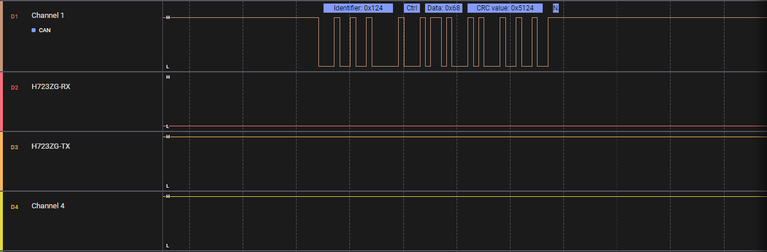

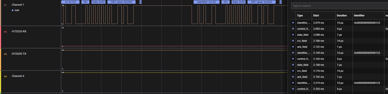

I've logic analyzer. I've connected the logic analyzer and taken the output.
connecting the G474RE board-1 with the H723ZG Board:

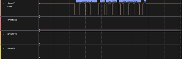

connecting the G474RE board-2 with the H723ZG Board:

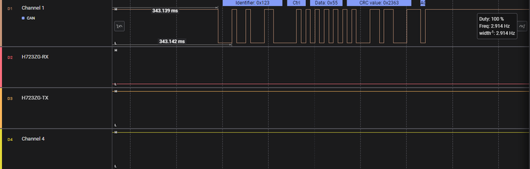

Srivatsan_0-1770960950475.pngconnecting the G474RE board-1 & board-2 with the H723ZG Board:

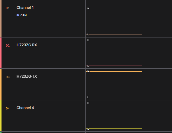

Srivatsan_3-1770961068160.pngconnecting only the H723ZG board-3:

I don't know what you did behind the scene. What Channel 1 refers to? G4 FDCAN Tx? or CAN analyzer Tx?
If one of them, H7 FDCAN_Rx is not receiving anything, so it's a hardware issue either a wiring issue or a transceiver issue.
- So check your wiring on H7 side
- Check the power supply of your transceiver
- Even, replace the transceiver used by STM32H7.
