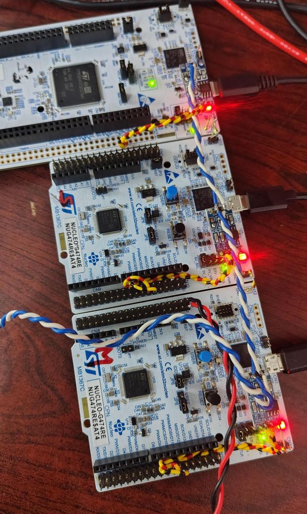

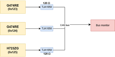

CAN communication between 3 Nucleo boards
Srivatsan
I am trying to establish CAN communication between three different MCUs: NUCLEO-H723ZG, NUCLEO-H755ZIQ, and NUCLEO-G474RE. However, I am unable to successfully communicate between the boards, even though the same baud rate has been configured on all MCUs. I have also connected an external CAN transceiver to each board for proper CAN bus operation.
On the NUCLEO-G474RE, I have enabled UART4 to send command data, using the following pins:
  • PC11 – UART4_RX
  • PC10 – UART4_TX
Clock Frequency [SYSCLK] & Baud Rate [CAN]:
1. NUCLEO-H723ZG: 550 MHz
    Baud Rate: 500000 Bit/s
2. NUCLEO-H755ZIQ: 480 MHz
3. NUCLEO-G474RE: 170 MHz

I am able to establish basic CAN communication between the two G474RE boards; however, I am unable to communicate with the H723ZG board, even though the baud rate is configured the same on all boards (500 kbit/s).
Despite using identical baud rates, the H723ZG does not transmit or receive CAN messages. Could you please help explain why this mismatch might occur and what configurations should be verified to enable communication with the H723ZG?

So as I understood you solved the communication issue between STM32G4 based boards. Still STM32H7 based board is not working.
I've already asked the following questions in this thread (That's why we prevent the threads duplication:(
1-You need to tell what the problem is? on which side? on transmit or on receive?
2- Please describe what you've did at this stage to debug the issue.
3- Show your hardware schematic.
PS1: avoid using HSI for CAN and use external precise clock source such as a crystal. Here you are using HSI for G4 project!
PS2: please attach the ioc files instead of sharing screenshots of your CubeMx config
We can't help you if we don't have all the elements needed.
Thank you for your understanding.
1. The problem is on the RECEIVE side
2.
  • Enabled FDCAN properly
  • Set classic CAN (good)
  • Matching bit timing (mostly OK)
  • Sending known ID (0x125)
  • Toggling LED to prove firmware is alive
  •  Using real transceivers (TJA1050)
3.
I've disabled into the HSI clock for G4 projects, and the projects files are attached below.
Does this mean STM32H7 is able to send CAN frames to other CAN nodes including the CAN bus monitor?
In this project, I have assigned H723 to receive the data. It's not receiving from the transmitter. I didn't transmit any data previously from the H723. I've assigned it only for the receiving side.
This is your main from STM32H7:
1- You are sending in the while loop while you said you are not sending anything.
2- How are you testing the Rx? I'm not seeing any RxCall back!

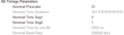

3- I said previously: please avoid 1Tq for TSEG&/TSEG2 timing configuration. Please review my posts above:
You’re right — I apologize for the earlier confusion.
I have now updated the baud rate to 1 Mbit/s on all boards (both G474RE and the H723ZG) by adjusting the clock configuration and nominal prescaler values. To avoid any further confusion, we can proceed with this updated configuration.
I will upload the .ioc files for your review. Kindly go through them and share any possible suggestions or corrections.

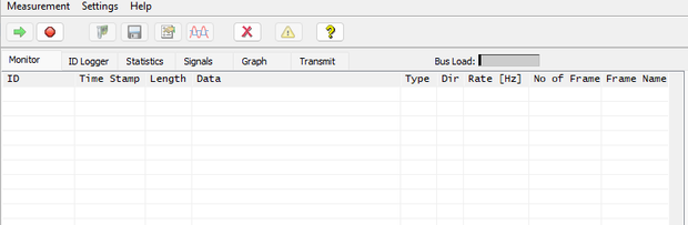

Even after changing the baud rate from 500 kbit/s to 1 Mbit/s, the two G474RE boards are communicating successfully with each other, but the H723ZG board is still unable to communicate with them.
Currently, data is being transmitted continuously in a loop. The CAN messages from the G474RE boards are visible on the bus monitor, whereas the data from the H723ZG board is not appearing on the bus monitor at all.
... whereas the data from the H723ZG board is not appearing on the bus monitor at all.

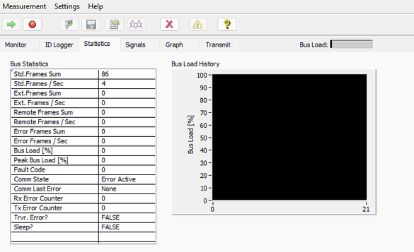

That is a bit too superficial.
Either enable diagnostics and bus error display with your monitoring tool / software, or use one that is able to do so.
Either there is a wiring problem within the H723 board so that it doesn't even get onto the bus, or it goes into "error passive" almost immediately.
Disconnect the other (working) receiving node, and check what the transmitting nodes says.
Check the bus signals, and monitor the TEC + REC counts on both sides.

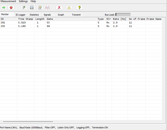

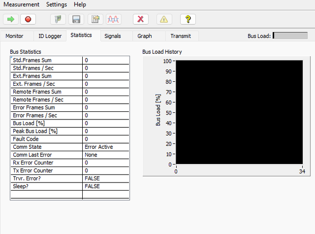

I've enabled the bus error display and monitored it with & without the working pair of boards (G474RE).
With the working board setup:
After disconnecting the working board setup:
Hardware Image:
I hope this is clear for you.
No not clear yet.
Do you have an oscilloscope or logic analyzer? if yes could you please probe FDCAN_Rx pin from STM32H7 side?
Please don't change the bitrate or anything else while we are analyzing the issue, you complicate things..
The photo doesn't show the interesting parts: the transceiver etc ..
