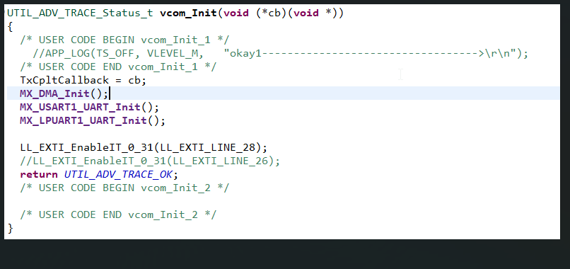

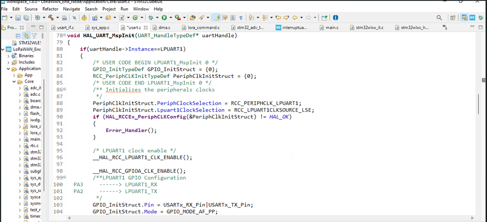

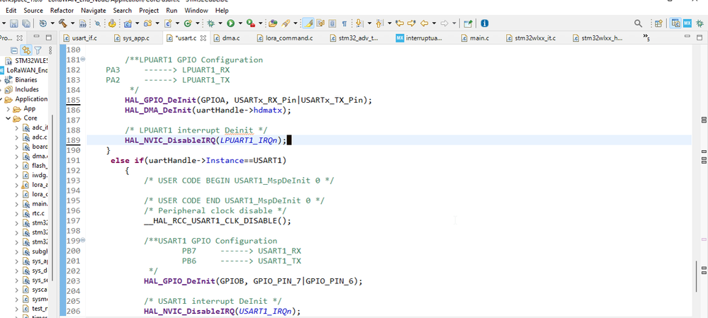

Currently I am working in Uart interrupt in along with LoRaWAN in RAK3172 module(STM32WLE5JC MCU).
I had worked with 2 UART interrupt without LoRa its working fine which was generated in STM32CubeIDE.
while trying to integrate one Uart interrupt with another LPUART interrupt which was used for AT commands configuration in LoRa its not working.
Below I have attached the Configuration Screenshot step by step
Kindly support for rectify this issue.
Thank you!
SS.28

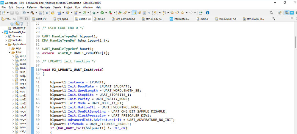

Step 1: LPUART init function0693W00000WKN3uQAH.png
Step 2 : UART1 init function

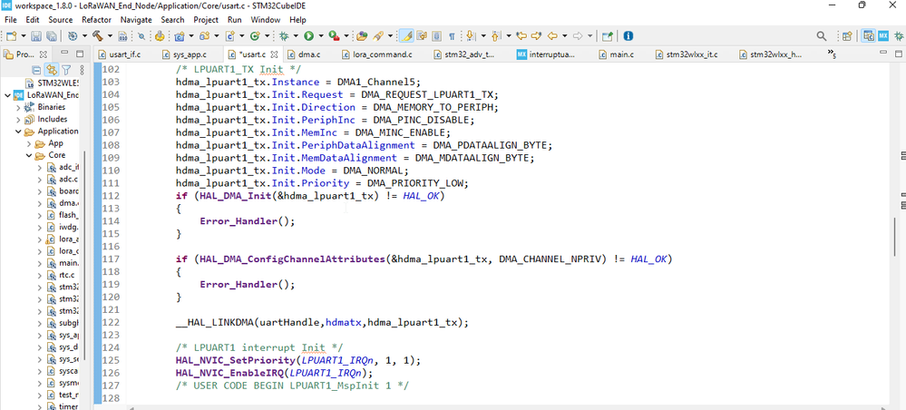

Step 3: Uart Msp init

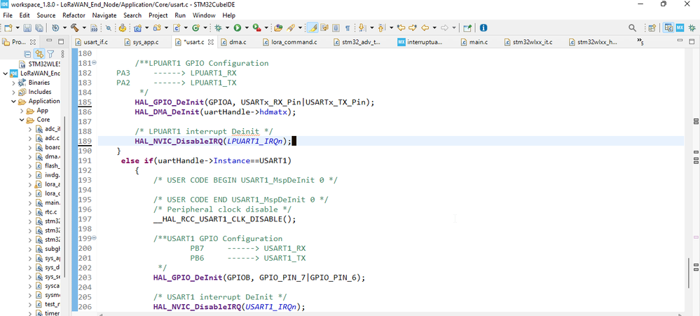

STEP 4 : UART MSP Deinit
SS.28

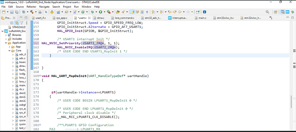

Step 5: Calling UART

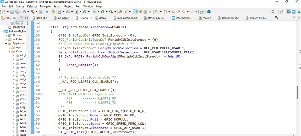

Step 6:Uart Callback function
 uint8_t UART1_rxBuffer[1]={0};
 uint8_t a[1]={0x00};
Don't put Blocking functions in callbacks, they are done under interrupt context, and will stop other interrupts of same/low priority from executing.
Do whatever work you need to do and leave, quickly.

I have changed the NVIC priority in LPUART1 (PreemptPriority, sub Priority-->(1,0)) and UART1 (PreemptPriority, sub Priority-->(2,1)) still now I have facing same issue
Kindly guide me to rectify this issue

Was the default lora sw define an uart interrupt handler and yours is not used? Test by trying to put breakpoint in yours.
Interrupts as said before should be very brief as they replace hw.... header byte screening, push byte in a sw fifo to queue them up for other slower non interrupt sw to manage.
You should put both uart interrupt same prio.
Put breakpoint in each isr to check you *** there. Even stop the code, check the hw registers values to make sure all is well configured, manually adjust amd let the code continue untill you get the interrupt breakpoint. You are in code debug mode, dig...
