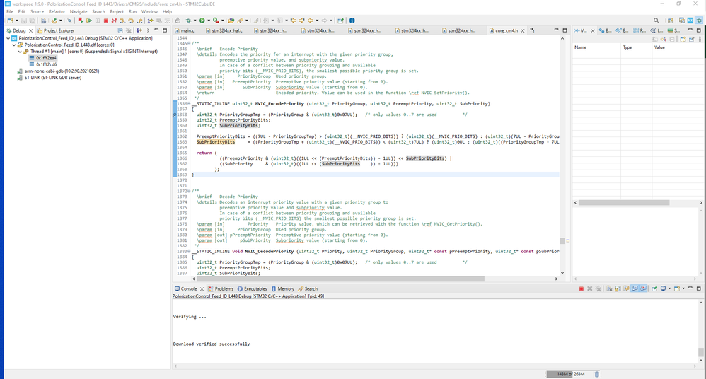

It appears to be failing on this one as soon as I single step out of the NVIC_EncodePriority inline function.

__STATIC_INLINE uint32_t NVIC_EncodePriority (uint32_t PriorityGroup, uint32_t PreemptPriority, uint32_t SubPriority)
  uint32_t PriorityGroupTmp = (PriorityGroup & (uint32_t)0x07UL);   /* only values 0..7 are used          */
  uint32_t PreemptPriorityBits;
  uint32_t SubPriorityBits;
  PreemptPriorityBits = ((7UL - PriorityGroupTmp) > (uint32_t)(__NVIC_PRIO_BITS)) ? (uint32_t)(__NVIC_PRIO_BITS) : (uint32_t)(7UL - PriorityGroupTmp);
  SubPriorityBits     = ((PriorityGroupTmp + (uint32_t)(__NVIC_PRIO_BITS)) < (uint32_t)7UL) ? (uint32_t)0UL : (uint32_t)((PriorityGroupTmp - 7UL) + (uint32_t)(__NVIC_PRIO_BITS));
  return (
           ((PreemptPriority & (uint32_t)((1UL << (PreemptPriorityBits)) - 1UL)) << SubPriorityBits) |
           ((SubPriority     & (uint32_t)((1UL << (SubPriorityBits    )) - 1UL)))
It comes in with PriorityGroup = 3
PreemptPriority = 0
SubPriority = 0
It creates:
PriorityGroupTmp = 3
PreemptPriorityBits = 4
SubPriorityBits = 0
When I exit this routine with a single step, the debugger stops working. The only thing I can do is Terminate.
If I suspend it says 0x1fff2ea4 but I do not know how to interpret that,
0693W00000Y7svuQAB.pngAre there any ideas where I should look to get this working?
