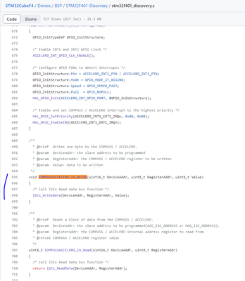

Hey st i am working with the stm32f407g and i am trying to make the LSM303 working on my board. At this moment i am using this lib: https://github.com/STMicroelectronics/STM32CubeL4/blob/master/Drivers/BSP/Components/lsm303dlhc/lsm303dlhc.c
The problem i am having is that it cant find the COMPASSACCELERO_IO_WRITE function and the COMPASSACCELERO_IO_Init function. I think this is because i am missing a .A or .LIB. Could i get help with this?

hello @Chris_student
You could find what you want here (function definition):
https://github.com/STMicroelectronics/STM32CubeF4/blob/master/Drivers/BSP/STM32F401-Discovery/stm32f401_discovery.c
As you are using F4 devices, you could find information into the F4 discovery board BSP.
Best regards
Mikael

I did but it did not work, i added these 3 libs because they are needed and made sure the path was right but it wont work. when i open the declaration of COMPASSACCELERO_IO_WRITE i get passed to the .h file so thats good but i can not find the function it self enywhere. because as far as i know there should be a function of COMPASSACCELERO_IO_WRITE with code in it. But this is no where to be found.
(COMPASSACCELERO_IO_WRITE is a function that gets called by multiple functions in the .c file)

‎2023-10-11 8:37 AM
I see i am missing some of the basic libs that come with the discovery board thanks a lot!
