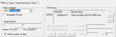

I am trying to program STM32 Blue pill board using Keil, and it gives the following error: "Connection refused due to device mismatch; Device connected to debug unit is different from device selected for project target STMicroelectronics STM32F103C8." I am using ST-Link debugger for programming as it does not have on-board ST-debugger. The issue is that it reads chip ID:0x2BA01477, which, I have read on other forums, is the ID read when your board uses clone instead of real STM32F103C8T6. Still, I want to program it using Keil. When I program the same setup using Arduino IDE, it is gets programmed in a perfectly fine way. Is there any other way to resolve this error in Keil using the same board or there is no other option left but to replace the board?

You have also a fake /non STM chip on the st-link - thats why its not working !

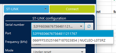

@IMumt.1 this is what real ST-Link serial numbers look like:
So another benefit of getting a e NUCLEO-F103RB is that it comes complete with a genuine ST-Link.
You really are reaping all the benefits of all this fake/clone kit !

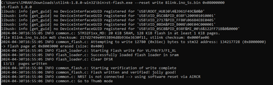

I tried reading the serial number of st link using st-link utility and got this.
I was able to see a similar or the same serial number in keil however, now i only see "4".
I also tried to flash a blink file (compiled using arduino IDE) using st-link utility and was successful.

So are you using a genuine ST-Link, or a fake/clone?
Note that anything looking like this is a fake/clone:
Another one of the "benefits" (sic) of these fake/clone ST-Links is that do not have consistent pinouts - they can be different, even when bought from the same place!

It's been established that the reason Keil won't program the board is exactly as it says in its error message - you have the wrong chip on the board!
Presumably, the Arduino IDE just doesn't make that check.
