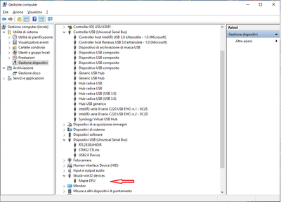

Hi, I'm trying to figure out how to program this MPU with the Arduino IDE.
I tried to make the serial port appear but without any success.
Unfortunately I have lost all reference to the purchase and it seems that RobotDyn no longer exists.
I tried the following configurations:
BlackPill F103C8
BluePill F103C8
BluePill F103C6
I tried to install the bootloader with STMCubeProgrammer using the following bootloaders:
generic_boot20_pc13, generic_boot20_pc13_fastboot, maple_mini_boot20
I installed the following USB drivers:
install_drivers.bat
install_STM_COM_drivers.bat
wdi-simple.exe
In all possible permutations, but I was able to program this board.
And STLINK isn't even displayed, at most I see a Maple_003 port which I tried to use but without success.
Where am I doing wrong ?

‎2023-10-17 11:46 AM
Hi Ascha.3,
with these latest versions it is no longer possible to use the STLINK as you can see even using the IDE 1.8 there is no possibility of programming this board with STLINK.
Using both BlackPill and BluePill or MapleMini, I don't have much chance they are always the same...
Thank you for your help, but we need something more sophisticated, which unfortunately I don't have; the ability to thoroughly understand this type of hardware and also software.
Unfortunately I'm inexperienced.... :frowning_face:

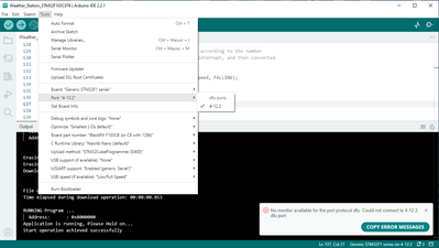

‎2023-10-17 12:37 PM
So what's the STM32CubeProgrammer (SWD) option?
‎2023-10-17 8:25 PM
Wow !!!
Many thanks "Tesla DeLorean", now I can program it, but is there no way to have a serial port to check its operation?
Sketch uses 39712 bytes (60%) of program storage space. Maximum is 65536 bytes.
Global variables use 9716 bytes (47%) of dynamic memory, leaving 10764 bytes for local variables. Maximum is 20480 bytes.
STM32CubeProgrammer v2.14.0
ST-LINK SN : 52FF6B064987495141430787
ST-LINK FW : V2J42S7
Board : --
Voltage : 3.24V
SWD freq : 4000 KHz
Connect mode: Under Reset
Reset mode : Hardware reset
Device ID : 0x410
Revision ID : Rev X
Device name : STM32F101/F102/F103 Medium-density
Flash size : 128 KBytes
Device type : MCU
Device CPU : Cortex-M3
BL Version : --
Memory Programming ...
Opening and parsing file: Weather_Station_STM32F103C8T6.ino.bin
File : Weather_Station_STM32F103C8T6.ino.bin
Address : 0x08000000
Erasing internal memory sectors [0 39]
Download in Progress:
File download complete
Time elapsed during download operation: 00:00:00.857
RUNNING Program ...
Address: : 0x8000000
Application is running, Please Hold on...
Start operation achieved successfully
‎2023-10-17 8:59 PM
Now the situation is this, I can program the board but I don't have the possibility to use the monitor for debugging.
Are there any solutions?

‎2023-10-18 2:32 AM
Arduino has no debug .
just serial monitor - if you talk about this.
‎2023-10-18 5:38 AM
Hi, yes AScha.3 i talk about Serial Monitor.
‎2023-10-18 7:01 AM
ok, if st-link is connected for program/flash,
and then the program makes VCP over USB, you need to connect extra cable from PC to mini/micro-USB plug.
‎2023-10-18 9:04 AM
Yes, it is connected to my PC end mini USB
