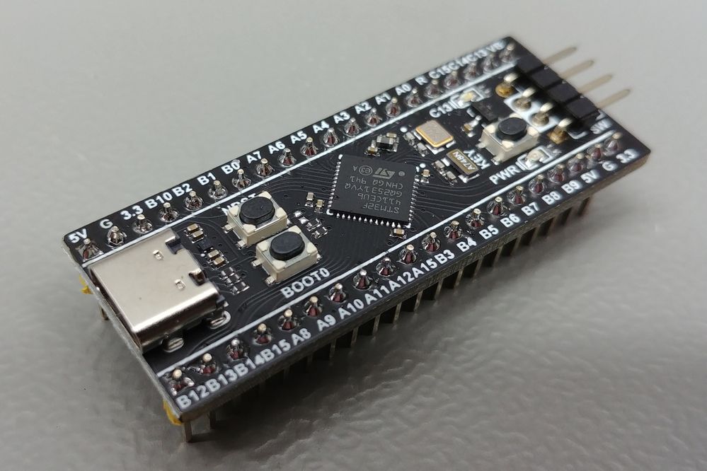

I'm trying to run the eaxmple found in this link: https://deepbluembedded.com/stm32-serial-port-uart-with-usb-ttl-converter-pc-interfacing/
I'm able to read the data from MCU serially, but when I write, the GPIO is not getting toggled. I've configured the MCU as described. I'm using blackpill v3 board. What I suspect is there is an issue with type conversions. But not sure. It would be very helpful if someone can help me with this.

Andrew Neil
Not sure what you mean by "read from the MCU" and "write" here ?
How do you determine that, "the GPIO is not getting toggled" ?
What do you mean by that, and why do you suspect it?
What I meant by read and write is RX and TX of the UART. I've a if condition which basically checks the serially transmitted data and sets the GPIO high ot low accordingly.
By type conversions what I meant is, Do I've to convert the received byte to char to compare in the if statement?
what "if condition"? Where? How does it check?
Present the code you're actually running so we can see what you see..
Paste in via </> tools, or on your own GitHub

Hello, Thanks for the responses. Please find the piece of code I'm trying to run below.

Also, The board I'm using currently is this:
So, When I run the above code. The corresponding GPIO is not responding. Kindly help. Thanks in advance!
- Create a standalone basic program that toggles the LED, make sure that part works as expected. If not, debug that first. There may be a missing jumper on the board required to connect the pin to the LED.  Also check the schematic to ensure C13 designates a pin and not a capacitor (!).
- Use a debugger to check the value stored in the variable after the UART RX to ensure it matches your expectation.
- In the code shown, it doesn't look like casting is the cause behind your issue.
- If someone's post helped resolve your issue, please thank them by clicking "Accept as Solution".
- Please post an update with details once you've solved your issue. Your experience may help others.
Thanks for your response. As you ,mentioned, I already tested the GPIO pin C13 and it's working fine. But When I try to fetch serial command and then set the GPIO, It's not working. I'm still trying to debug and fix the issue.
I don't have a debugger. I'm using the serial transmit to try printing the value. But still no luck.

You have:
    HAL_GPIO_WritePin(GPIOC, GPIO_PIN_13, 0);
in all cases, it is never set high.
