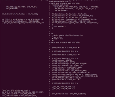

And the diff from the working neucleo board F301 I think!

bibble235
So anyone trying and have my problems.
I followed the youtube https://www.youtube.com/watch?v=e_NSqz5P8Qk and this worked for me. Diffing between first attempt and this shows
Where the working code is on the right. Not sure why but clearly the suggestion around the clock configuration is a pointer.
Thanks.
