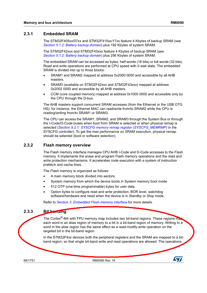

I am not very familiar with the Low-level stm32F register,
I have a question about the definition of each register in the  TIM_TypeDef
I want to have a separate access to each bit, It is possible?

I want do something like this:
TIM2.CR1.bit.CEN = 0;
Is it possible, if not could help me to use the masks configured bit by bit?

Are you asking whether STM32F4 supports so called bit-bands as in some other MCUs? No it does not.
Just read the whole register and apply the usual C bit operations.
Also, someone posted here a nice C++ register class which allows bit-level manipulation.
This is not true.
0693W00000NqrcOQAR.pngHowever, I don't recommend bit-band access on anything but pure setup registers.
Nonetheless, OP probably asked about predefined bitfields for the registers - there the answer is, no, accept what's there, learn to live with the usual C bit operations as Pavel recommended above.
