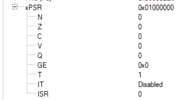

As an example, here's what Keil shows:

Other IDEs and debuggers can view the current xPSR values split up as a bitfield in the IDE registers window. STM32CubeIDE does not appear to be able to do so. I was asking if there was a way to do what seems like a very useful and programmatically trivial thing that is already available for the peripheral registers.
I know I can manually do the maths to work out which bits are set, and I know there are compiler intrinsics to read it programmatically, but that is no help when I want to debug the code and see real-time which flags change.
Context: I'm teaching a class on embedded systems at a low level, and I want the students to understand why when they add one to 0x7FFFFFFF the N flag and V flag get set even though an `unsigned int` is still a positive value. It's easy to do in some IDEs where they see the flags flip over, now I've got to tell them to decode the bitfield by hand.

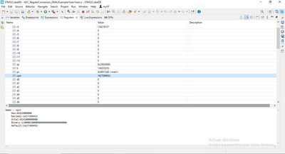

Hello again
Using CubeIDE this is the best result we can have.
 I hope you can use it with your students.
Best regards.
