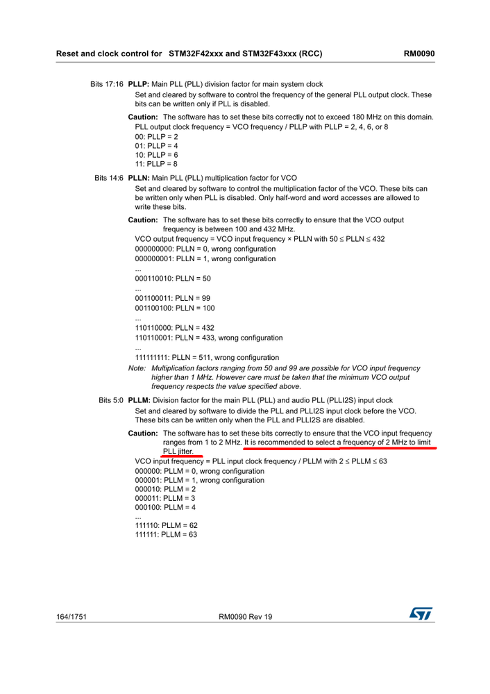

Usually it comes down to the preferred comparison frequency range, and the most stable operating region of the VCO pulse generation.​
On the F2/F4 this was 1-2 MHz and 200-400 MHz.
Y​ou always need to divide the VCO down by a power of 2 to get 50/50 duty cycle square waves to clock the MCU

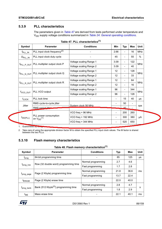

For some families' PLL, there may be some preferential setting, e.g. for 'F4:
0693W00000aIaczQAC.pngFor 'G0, there may be no such stated preference, I did not search. In that case, any combination which obeys the limits for PLL's VCO and dividers, given in DS, will do.
Note, that PLL is to large extent analog and such preferences change from family to family because of different technologies and PLL component designs used, so such preferences are not transferrable.
PLL settings may also influence current consumption, within limits given for the PLL module.
