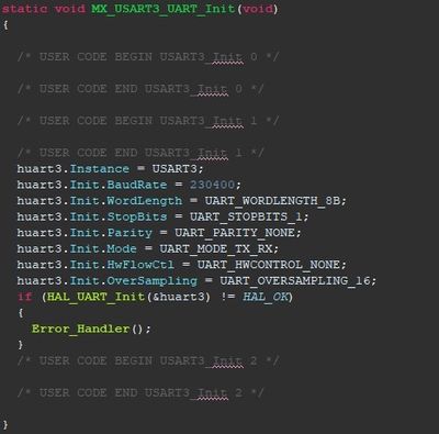

Hola, presento este error al visualizarr los bytes de salida por putty ▒``x▒▒▒▒▒▒▒`▒▒ ciclicamete, ya que es para un lidar ld06, connfiguro uart 2 velocidad de baudios 230400
la configuracion es

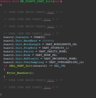

Otherwise you have only posted the clock configuration, but neither the settings of UART2 nor the UART code used.

 Hello, I am attaching the relevant configuration. On the other hand, I thought that maybe the error could be in the configuration of the watch, that's why I had attached it

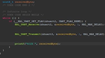

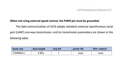

Does the Lidar output in binary? That's not going to be human readable unless you process it, into say angles / distance. Dump the records you are receiving into Hex, or something you can correlate with the MANUAL.
If the baud rate is wrong, check HSE_VALUE, and the clocking of the MCU
Check output rate of STM32 with a scope, sending U / 0x55 patterns.
Check the output rate of the Lidar with a scope, check bit timings, sync patterns, etc.
I thank you, I don't know much about the subject as you can see, so it had occurred to me to be able to see the bytes that is receiving the plate through the uart. Is the idea crazy?
To get readable hex from the STM32 you'd need to be outputting 3x as fast. So sprintf(str, "%02X ", byte) can off load the data.
Alternatively, use RealTerm and have it output in hex mode, and it will show you the patterns.
There should be a specific sync byte(s), or header for each scan. The number of scans in Hz will depend on the spin speed of the Lidar.
