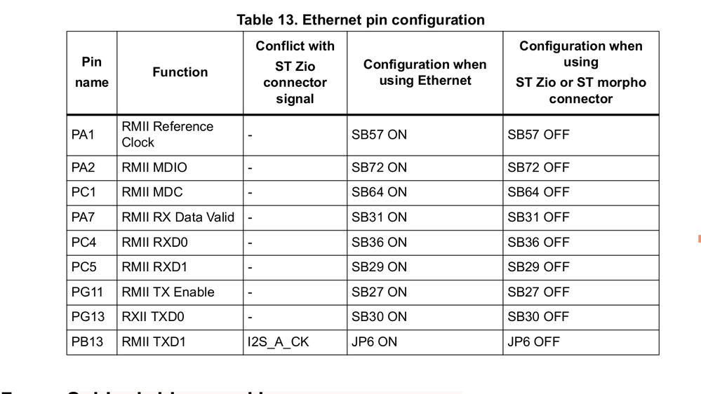

EDIT: you were absolutely right. Removing L1 reduced the Nucleo-H743ZI2 board current draw from USB power at 5.14V from 155 mA down to 107 mA, and the peak-to-peak ADC noise dropped by a factor of 5.
In one before-after experiment using the "ADC 14-bit optimized" setting in CubeMX, 32 oversampling ratio, but only 3 bit shift so you get a nominal 16-bit result, it went from 414 counts with L1 installed, to 82 counts with L1 removed.  That is quite worthwhile.
MasterT
Lead
Check out UM2407, there are listed some jumpers for ethernet to remove first.
