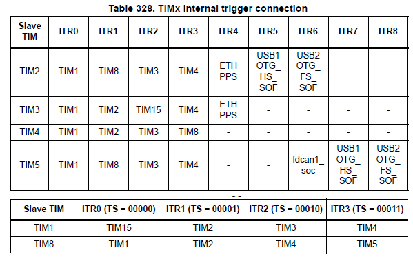

You can output only one of the OCxREF as TRGO, not both, see TIMx_CR2.
That then could be input to some of the connected timers, see interconnection chapter in RM, and the TIMx_SMCR register for the chosen slave timer.
‎2020-05-03 5:24 PM
One trigger is fine for me. I still can reconfigurate the stepper driver to only act on a rising edge.
I attached the matrix from the RM.
I could take Tim8 as slave for Tim2 via ITR1 and take Tim5 as slave for Tim1 via ITR0.
I put both timers in "External clock mode 1" and then they should count up on every event. This sounds nice.
I will try this tomorrow (I will give feedback then, it is pretty late here right now).
Thanks alot
‎2020-05-04 4:15 AM
Thanks again, works perfectly :)
