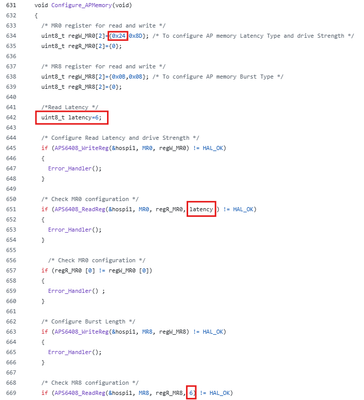

The regW_MR0[0] is 0x24, yet regR_MR0[0] is 0x88.
Clearly the XSPI bus timing has some issues.

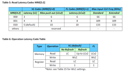

Hi @Maxim357 ,
Some suggestions for your reference:
1. Set the correct Read Latency when MR read (according to the clock frequency)
    For the sample code: Projects/STM32U575I-EV/Examples/OCTOSPI/OSPI_PSRAM_MemoryMapped/Src/main.c
     regW_MR0[0]==0x24 -> Read Latency Code (LC) = 4 (clock <= 109MHz)
     "uint8_t latency" should be set 4 if clock <= 109MHz
     Please use low speed clock (ex: 50MHz) to test first.
