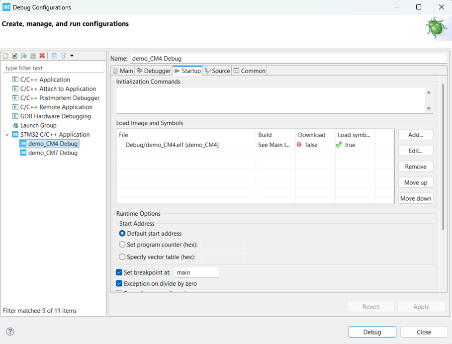

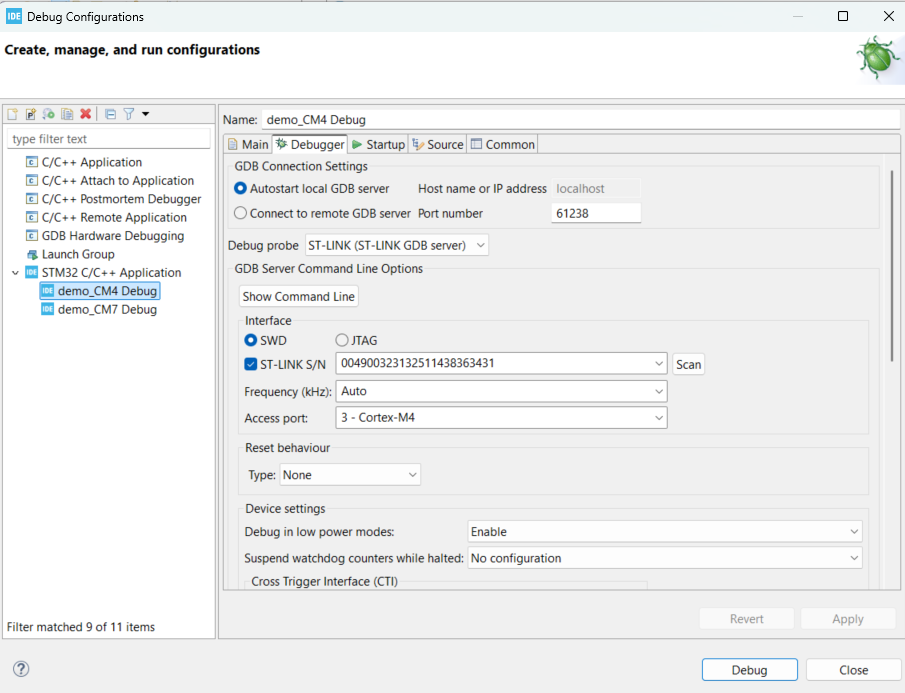

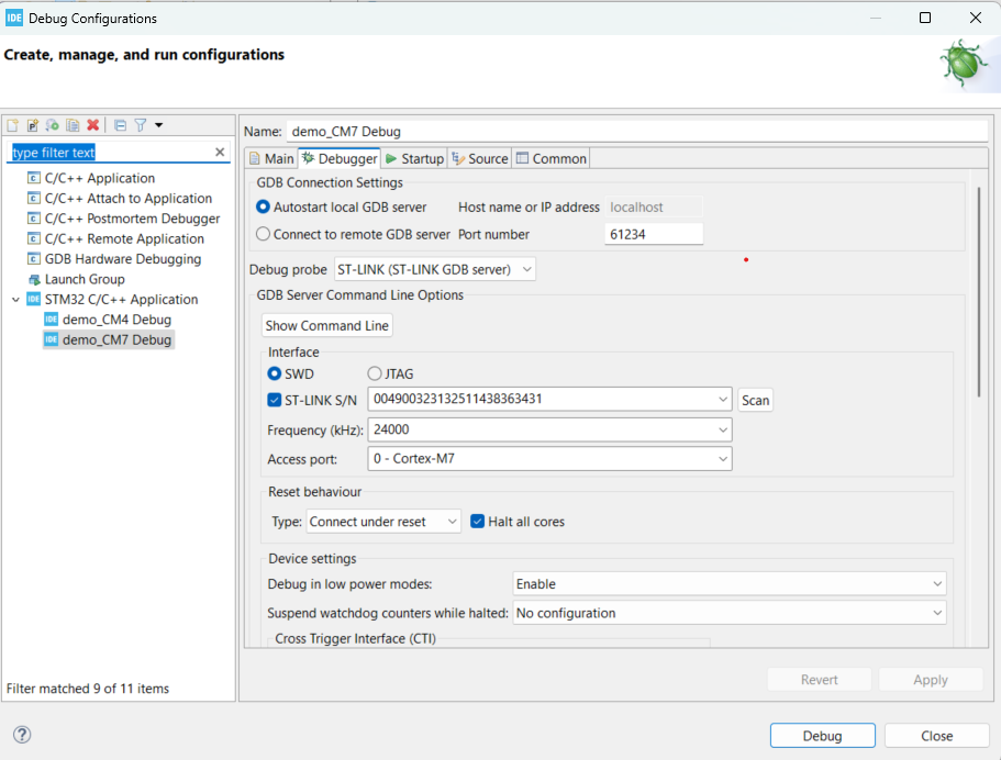

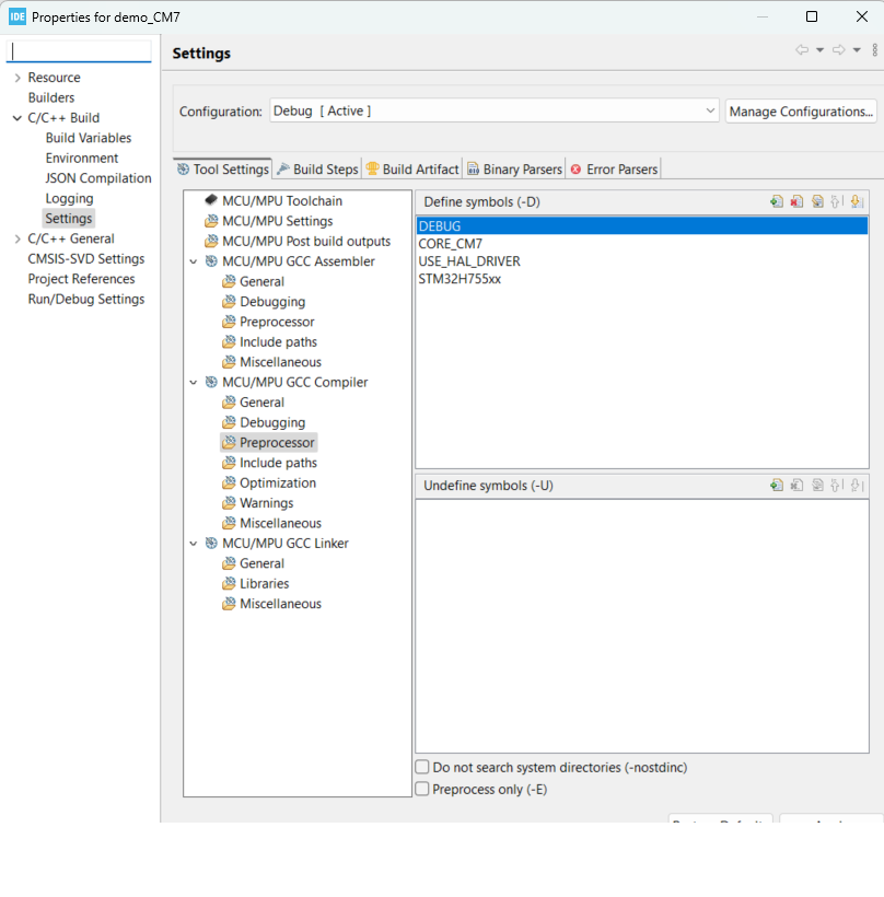

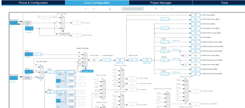

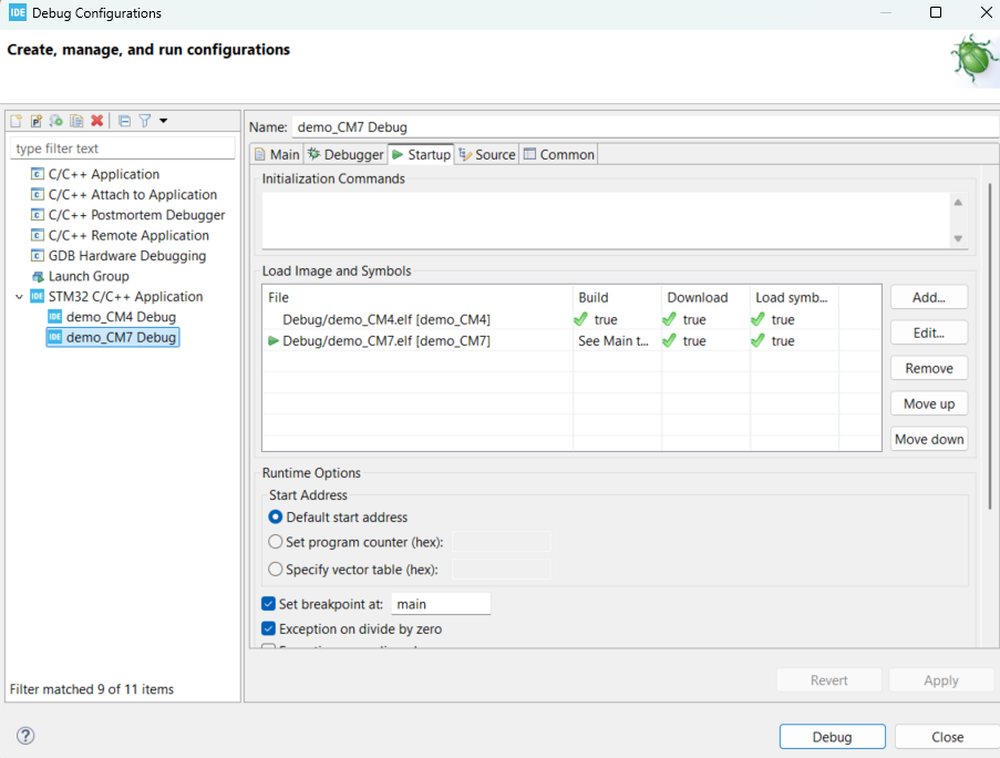

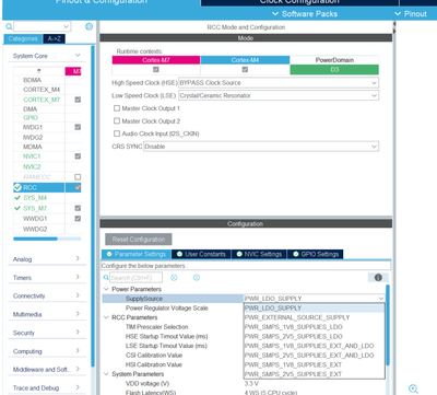

I'm experiencing the same issue that others have reported with the STM32H755ZIT6. Despite following all the suggested solutions step by step from various forum threads, I’m still unable to debug or run code on my Nucleo board.
Every time I try, the board locks, and I have to manually erase the flash by wiring BOOT0 to VDD to recover it.
I'm using the latest version of STM32CubeIDE, and I’ve attached some screenshots of my project setup for reference. I’d appreciate any guidance or additional suggestions you might have.
 M4_Starup.pngM4_Debug.pngproject_ioc.pngM7_startup.pngM7_Debug.pngProp.pngSTMH7_ioc.png

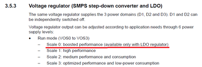

Hello @andrdz25 ,
It disappears because I'm pretty sure you set the system frequency > 400MHz @VOS0.
VOS0 is available only with LDO. SMPS can be used only when the system frequency < = 400MHz.
From the datasheet:

Hello @andrdz25 and welcome to the community,
What board are you using? if it is a custom board you need to specify what power configuration that board is configured to.
If it's a Nucleo-H755ZI-Q board you need to set the power config to Direct SMPS instead of LDO:
And you need to recover the MCU first.

I already tried to change that, but I couldn't find the option in STM32CubeIDE. I'm not sure if it's due to the core frequency or voltage settings. As you can see, the PWR_DIRECT_SMPS_SUPPLY option disappears. And yes, the board I'm using is the Nucleo-H755ZI-Q.
Hello @andrdz25 ,
From the datasheet:
