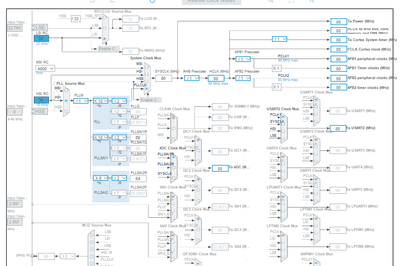

Also, for my project I used STM32L476RG Nucleo-64 board and in clock configuration, I think only internal oscillators are used.
I am not sure if tere is a passive use of the HSE and LSE because I think those are like default for every stm32 project but I am trying to understand why are LSI RC and HSI RC not enough. Not stable with temperature changes maybe because of RC or precision, not sure. Appreciate any help. Also is the reference design on here: https://www.st.com/resource/en/application_note/an4555-getting-started-with-stm32l4-series-and-stm32l4-series-hardware-development-stmicroelectronics.pdf is enough to design my custom stm32 based board or do I need any other sheets for reference? Thank you

LSE and HSE are preferable for accuracy and stability. If those aren't concerns for you, HSI/LSI are sufficient. Doesn't look like you use LSI anywhere--it is typically only used on low-power projects. USART needs some amount of accuracy, typically +/- 2% or so. HSI should be sufficient here.

I am working with high frequency data, using ADC as its max speed and also SPI to send this data. the system seemed to be working without LSE or HSE but I will still try to add those oscillators if size will not be an issue.
