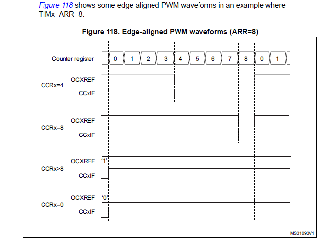

Spotted a small error on the Timer application note AN4013r6 (Cross Series Timer Overview), page 15.
Pulse Length of a One Pulse Mode is shown as: Pulse-Length = (ARR - CCRy)/(TIMx_CLK/(PSC + 1))..but by referring to the timing diagram in the Reference Manual (RM0090) of a MCU (STM32F407 for example), with my own experiment to confirm it to boot, that it should be Pulse-Length = (ARR - CCRy-1)/(TIMx_CLK/(PSC + 1)) instead.
I am not sure if there is another way to interpret or apply the equation..but it costs me some minutes to counter-check my config to find out because I started with the application note before digging further into the reference manual.
Please correct me if I am wrong.

Well spotted!
However, your formula needs proper bracketing
Pulse-Length = (ARR - (CCRy-1))/(TIMx_CLK/(PSC + 1))
or, it would be more appropriate to write
Pulse-Length = ((ARR + 1) - CCRy)/(TIMx_CLK/(PSC + 1))
as the raw reason is in that the 'pulse' lasts from CCRy to ARR *inclusive* (and the delay before that lasts from  0 to (CCR-1) inclusive).

Almost committed another mistake to the already wrong formula, thanks for pointing out!

This error is confirmed. It is reported, and will be fixed in next version of the application note.
Thanks for bringing it to our attention.
