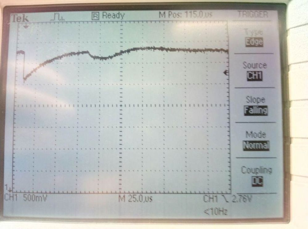

Hello!
On the PCB from LDO(
MCP1700T-3302E
) 3.3V are supplied 2 chips:GPS
SIM
68
M,
STM32L475RET6.
GPS power supply is controlled by STM.
When STM turn on GPS module voltage temporarily drops to 2,5V.
At this time MCU works incorrectly if frequency is 80MHz (hang or HardFault handler are called). If frequency 40Mhz all fine.
What could be the problem?
‎2018-03-01 2:21 AM
Just guesswork, but:
This suggests you have a power supply issue.
The current consumption of the MCU rises proportional to the core clock frequency.
I guess either your supply itself is too weak, and falters temporarily under the load, or you need better buffering (larger caps).

‎2018-03-01 6:09 AM
Most probably because the current surge from the GPS activation pulls Vcc down below 1.8V, or to the limit.
Dropouts in the microsecond range usually suffice to derail the core.
You would need a scope (and doing the probing near the supply pins of the STM32) to see what is going on there.
