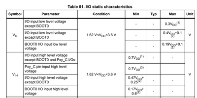

I'm using Nucleo H723ZG.
In my project, i need to detect a rising edge to trigger a callback. What i have done is that i setup a GPIO as external interrupt, and i verified the code by manually connecting and releasing from 3v3 pin. The actual signal i want to trigger is high for approx 38ns , and the callback is not triggering.
What is the best solution for this?
System operating at - 480MHz
Peripheral clocks - 60MHz
Timer clocks - 120MHz
edit : Can i use Timer input capture for that, does using it in one pulse mode mean it detects a rising edge and then resets until next trigger (as a slave timer)
edit: I tried the timer input capture too, but still same effect, I used the HAL_TIM_IC_CaptureCallback , One pulse mode is enabled, it is in slave mode, I even applied a 1MHz signal still callback is not triggering, when i applied a 100KHz signal the callback triggers properly.

@waclawek.jan wrote:
Make sure the signal has voltages for valid logic levels for your VDD.
+1
@sreyas40 wrote:
 i verified the signal in a logic analyzer.
Are you sure your logic analyser's logic thresholds match those of your STM32?
Would be worth also using an oscilloscope to verify that all is good in the analogue domain ...
