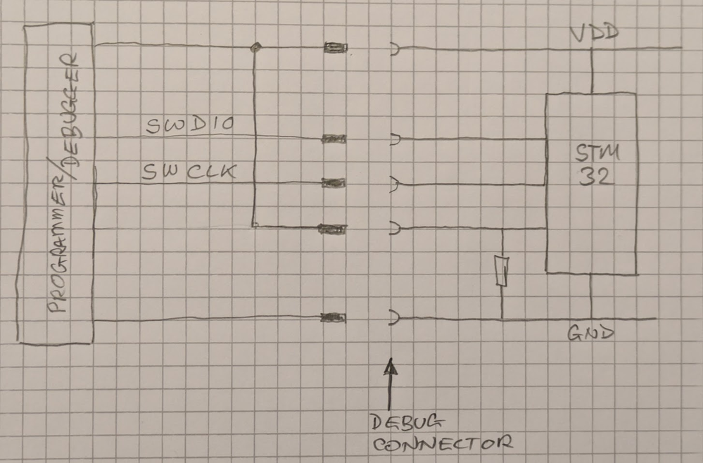

To add a bit to the reply of @gbm : instead of delay you can use a free pin (if there is one) as input. When you connect SWD, connect also that pin to VCC or ground. Without debugger, set the pin in the opposite state. Then the program will know whether to initialize I2C.  IIRC it is also possible to detect the debugger connection in the program, then no extra pin is needed.
This sounds logically right but is there any way or method to do it? Can the MCU used in both the configuration after I make a PCB for it?
Thanks for the additional information, How can a pin set to a opposite state? Like don't consider me a PRO :)
Can you please explain this technique?
You apply the signal externally:
  • If you apply VDD, SWD is active;
  • If you apply GND, I2C is active.
If you want the default to be I2C active, then fit a pull-down - then you only set it high when you want to use SWD.
The connector that you use to connect the debugger/programmer for SWD could include a link to set the pin high
PS:
eg, something like this:
