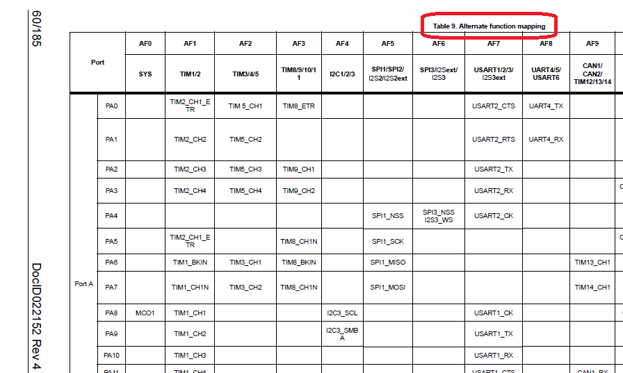

Hi all,
at page 135 of
http://www.st.com/st-web-ui/static/active/en/resource/technical/document/reference_manual/CD00240193.pdf
, I found a note: ''To know which functions are multiplexed on each GPIO pin, refer to the datasheets.'' But I didn't find the datasheet for
STM32F303VCT6.
At the end, I need to know which value insert in the registers GPIOx_AFRL and GPIOx_AFRH.
Can someone help me?
Thanks

waclawek.jan
Posted on December 11, 2013 at 15:33
Look into STM32F4xx datasheet, http://www.st.com/st-web-ui/static/active/en/resource/technical/document/datasheet/DM00037051.pdf , page 60 and on.
Posted on December 11, 2013 at 16:09
the datasheet you have mentioned above has specified the alternate function correctly but not in my case of stm32f407vg controller inUM1472User Manual....its like AF ..
Sometimes I wonder if people here are ********... Yes because they are different bloody parts, try Googling YOUR part
http://www.st.com/web/catalog/mmc/FM141/SC1169/SS1577/LN11/PF252140
and
http://www.st.com/st-web-ui/static/active/en/resource/technical/document/datasheet/DM00037pdf
0690X00000605WLQAY.png STM32F4xx_DSP_StdPeriph_Lib_V1.2.0\Libraries\STM32F4xx_StdPeriph_Driver\inc\stm32f4xx_gpio.h

umitguleer
Posted on November 19, 2015 at 13:32
hi clive,
I am learning new so I wonder, why  use alternative function and when alternative function.
Posted on November 19, 2015 at 14:35
There are more peripherals with inputs and outputs than there are pins on the device. The ability to multiplex (mux) them to different pins provides some degree of flexibility in the peripherals and devices used. Routing every function to every pin would require a ridiculous amount of silicon, so the the choices are limited, you might have to juggle things to get the set of functionality you want. It's not possible to use all peripherals at once, it's a general purpose device, and most people only need a subset for their designs.
When using external memory buses, and LCD, these soak up a lot of pins, and often require much higher pin count devices.
umitguleer
Posted on November 19, 2015 at 15:29
so I mean,  using LCD pins can use any purpose at the same time, am I right??
Posted on November 19, 2015 at 16:39
I'm not sure why this is so complicated. NO, you have multiple choices, but you only get to pick ONE function. Think of it like a Volume Knob with specific, discrete settings, 0..15
