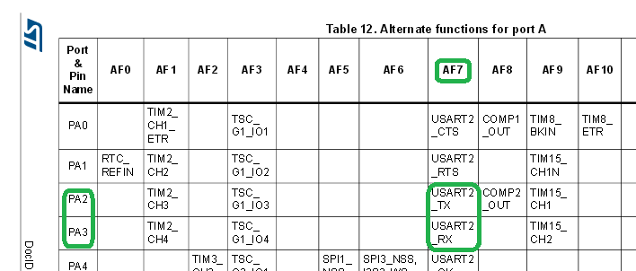

Hi all,
at page 135 of
http://www.st.com/st-web-ui/static/active/en/resource/technical/document/reference_manual/CD00240193.pdf
, I found a note: ''To know which functions are multiplexed on each GPIO pin, refer to the datasheets.'' But I didn't find the datasheet for
STM32F303VCT6.
At the end, I need to know which value insert in the registers GPIOx_AFRL and GPIOx_AFRH.
Can someone help me?
Thanks

Hi Clive,
thank you.
But I can't find the table with the values used for GPIOx_AFRL (for pin 0 to 7) and GPIOx_AFRH (for pin 8 to 15) configuration in order to select the appropriate alternate function.
Probably there is something that I didn't understand.

Click on the ''Pg 43'' link provided, navigate to Page 43, observed the table, AF0=0, AF1=1,..AF15=0xF

Thank you Clive,
now is clear:
for selecting the AF1, I need to write 0x00000001 both for GPIOx_AFRL and  GPIOx_AFRH as reported at page 147 of

You might want to select the Reference Manual for your part, RM0316
http://www.st.com/st-web-ui/static/active/en/resource/technical/document/reference_manual/DM00043574.pdf

I'm also having difficulty locating such a table for the STM32L152xB. The datasheet has a list of functions for each pin, but no table of how they are mapped to the AFRL/H. Any thoughts?

AFRL describes pins 0-7, AFRH pins 8-15. Each pin source is described by 4-bits, 8x4 = 32-bits in the AFRL/AFRH. The source AFIO[0..15] represents the 4-bit encoding.

the datasheet you have mentioned above has specified the alternate function  correctly but not in my case of stm32f407vg controller in UM1472 User Manual....its like AF ..
.USART2_RTS/
USART4_RX/
ETH_RMII_REF_CLK/
ETH_MII_RX_CLK/
TIM5_CH2/
TIMM2_CH2/
ADC123_IN1
any idea about AFx?
is it like AF0/AF1/AF2/AF3.........?

Look into STM32F4xx datasheet, http://www.st.com/st-web-ui/static/active/en/resource/technical/document/datasheet/DM00037051.pdf , page 60 and on.
