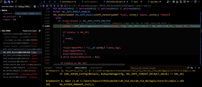

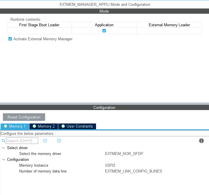

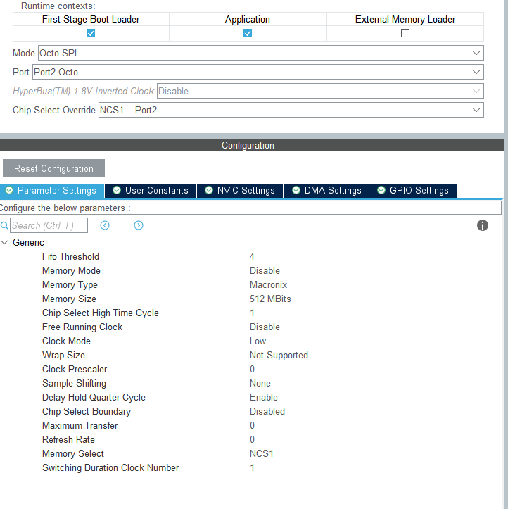

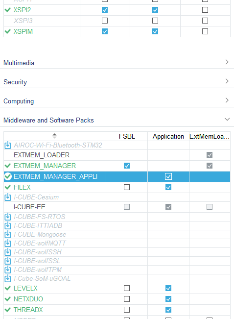

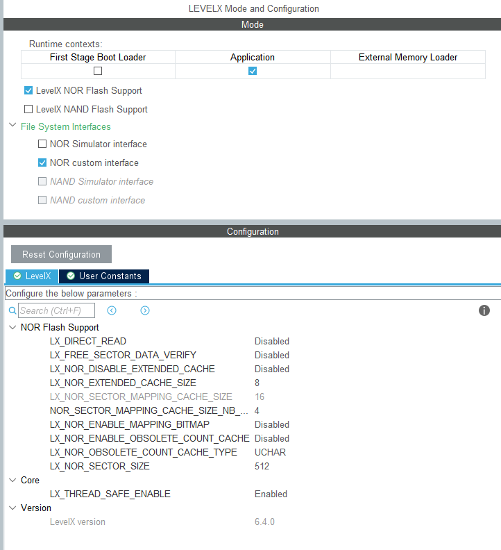

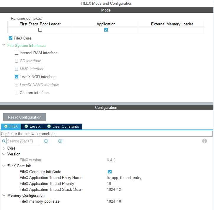

No matter what I try, XSPI2 times out on either infit or in EXTMem_Read in the application.
Screenshot 2025-07-08 081434.pngScreenshot 2025-07-08 081421.pngScreenshot 2025-07-08 081330.pngScreenshot 2025-07-08 081241.pngScreenshot 2025-07-08 081038.png

Attempting to DeInit and ReInit XSPI2 in the application causes the EXTMEM_Init to time out on initialization, even though the DeInit/ Init of XSPI2 and XSPIM do not throw any errors.

 Here's a screen shot of the call stack for where EXTMEM_Init() is hanging, and eventually entering hard fault due to timeout with the above version of XSPI2_Init():
