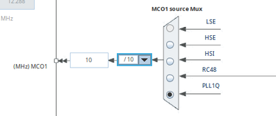

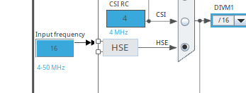

I'm here on H753, external clock, CPU clock configured to 400MHz. Setup code is generated by CubeMx.
If I execute a HAL_Delay() takes twice the time as expected, e.g. 2ms instead 1ms. I checked via GPIO toggle with a scope.
The MCO output is correct, so I guess the CPU clock is correct.
The system core clock variable is calculated/set to 400MHz after system clock initialization.
