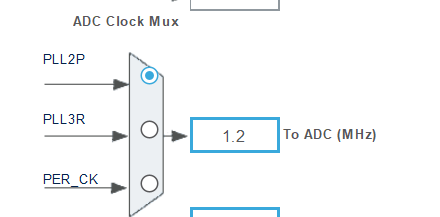

I changed the value of PLL2 in order to have a ADC frequency of 1.2MHz

f_ADC= 1.2MHz that i configured in clock configuration

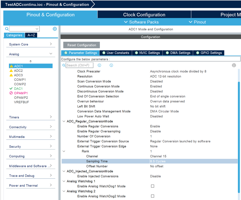

prescaler = 8 that I choose in the ADC parameter
nbcycle_samplingtime = 8.5 that I choose in the ADC parameter

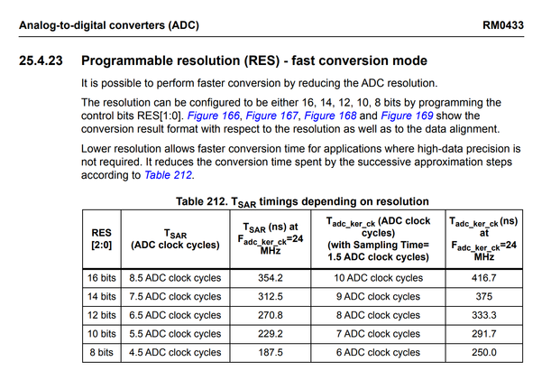

nbcycle_convertingtime that depends on the ADC resolution.
Some tutorials on the internet say the converting time is nbbits_ADC + 0.5, some others nbbits_ADC/2 + 0.5.
In the reference manual of this card, it appears to be  nbbits_ADC/2 + 0.5ADCdoc.png
So I wrote my parameters with this hypothesis.
I set a DMA of 40000 points, as the sampling rate is 10kS/s, this DMA is supposed to be half filled after 2 seconds, and fully filled after 4 seconds, with a period of 4 seconds.

Now, I suppose the hypothesis of nbcycle_convertingtime= nbbits_ADC/2 + 0.5 is wrong,
I suppose nbcycle_convertingtime= nbbits_ADC + 0.5
So I keep my previous parameters but change the sampling by 2.5.

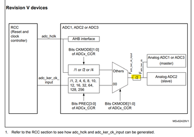

> As you can see the value is changing every 1/8th of the DMA buffer, that means the sampling rate is not what it is supposed to be. Also the period of filling the buffer is approximately 8 seconds instead of 4.
You are on the right track here but are likely missing an x2 divider in the ADC clock. You probably have a revision V device. See the clock tree in the reference manual:
> How can I get my 10k samples per second ?
Use a timer to trigger the ADC conversion instead of letting it free-run. Still need to be aware of how fast each conversion takes so you don't trigger it too often, but this lets you get whatever conversion frequency you want.
5 REPLIES 5

I just found your answer about this default x2 divider in another post. Thank you for your answer, it made it clear too.
